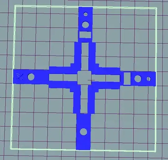

So I created a test object consisting of multiple "rectangles" (overlayed) in X and Y direction. Some of the dimensions were less than required and others bigger.test cross to calibrate.
So the holes ("drills") were 0.4 mm too small (so half a nozzle diameter). In "Cura" I could fix that with the newly added inner hole correction or negative horizontal expansion values. Yet this would also "cut" the thin parts (top and right rectangle on the image - with a width of 1.2 mm - so 3 lanes of print material on my 0.4 mm nozzle).
Without and with adjustment the inner width of the rectangles is also off by more than 0.2 mm.

    My experience is that the steps/mm for X, Y and Z should be set based on the theoretical values (given belt and pulleys). A cube will not be accurate anymore, but it's not an issue of "scaling" (which the steps would correct), it's an issue of "offset" (fixed additional thickness). Basically, your dimensions will always be "expected + fixed amount" (typically half nozzle). – FarO May 08 '20 at 07:58

    @FarO Yes, this is what you _could_ correct in Cura with a "negative horizontal offset" - but this also reduces thin walls so much, that eg a 0.8mm thin wall becomes a 0.4mm thin wall (so only one line of filament instead of two). And the 0.8mm thin wall would be printed very well. – GWRon May 08 '20 at 12:54
  • I personally don't use those options, I just design my parts with a half nozzle or one full nozzle tolerance. Except for holes: I leave them as originally planned, so that the half-one nozzle smaller size provides plastic for directly screwing bolts (which thread the plastic themselves) in them. They are quite strong, unless you screw them too tight and you strip the thread. – FarO May 08 '20 at 14:14
  • I cannot design "around the flaws" of my printer (or FDM printing in general). I often print stuff for raw "prototyping" before sending them to professional services for final "printing" (laser sinting etc). For my private stuff I just make gaps a bit wider so stuff still fits. – GWRon May 08 '20 at 14:20
