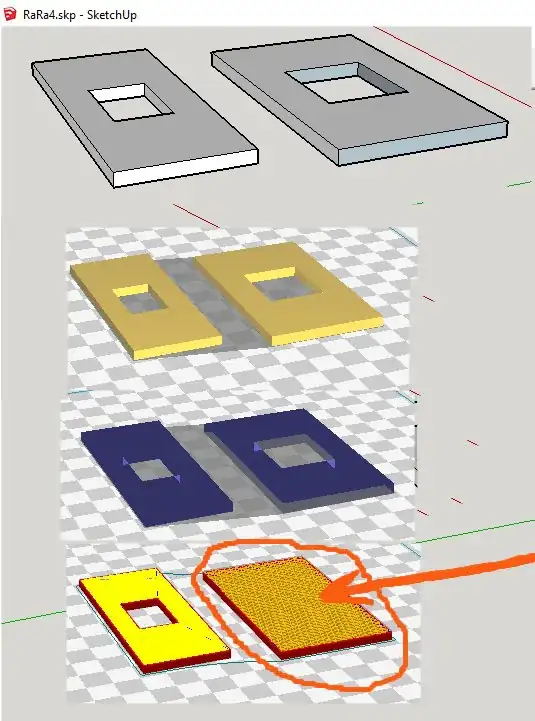

When I export my SketchUp STL model to Cura it looks good in solid mode but in the layers mode some holes are filled up. To find the reason why, I broke down the original model by deleting the parts that come out ok, and ended up with a block 50x100 mm with a hole 30x20 mm in it. This simple stucture looks manifold, no double lines etc, and does not have red parts in Cura xray.
Cura shows the model as expected, but in layers mode the hole is filled up. I spent many hours to find out, but so far my only solution is to start over again drawing a complete new model and even then this happens again.
I'm using SketchUp 2019, Cura 4, Meshlab 2020
What goes wrong here? How can I repair this with Meshlab?
STL file available on request.

Problem Statement
SketchUp does not always create STLs in ways that are closed, watertight manifolds - a block with a bore is, if created as a block first and then bored out, actually 2 surfaces if made with SketchUp:
  • a cylinder with its normals facing inside and no top and bottom
  • a block that has 2 holes in opposite surfaces
The two surfaces are not connected. As a result, Cura sees two non-manifolds and tries to fix each of them - the cylinder with the normals facing inside is considered an artifact that can't be fixed, the holes in the block are stitched and thus turned into a solid block.
Fixing
To repair the issue, you could load the item into for example MeshMixer, which allows to separate and show the different surfaces (shells) and run a rather good auto-fix.
Another program that, with a little handiwork could help is blender. In blender you can first import the STL, then merge the vertices at the edge of the bore and cut cube and thus turn the two shells into one neatly, then re-export it as an STL. I strongly suggest to just add it to your Steam library if you want to keep it up to date.
