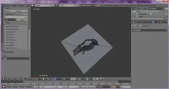

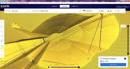

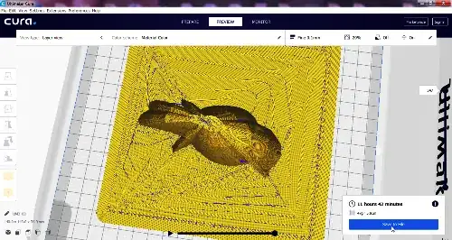

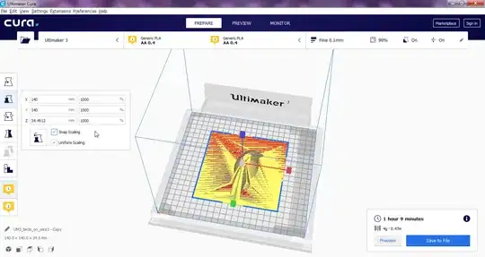

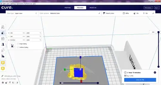

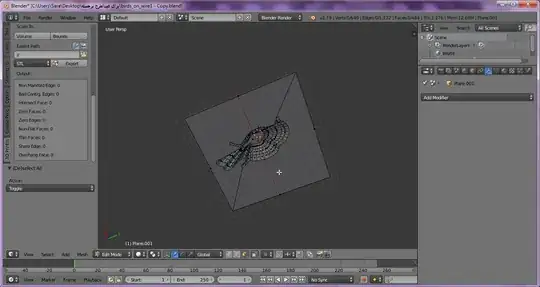

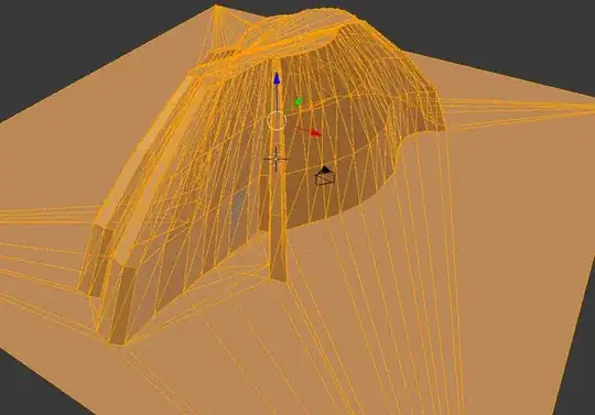

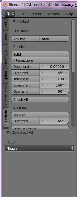

I'm new to 3D printing. I modeled an empty bird in Blender (the stl file of model is presented). I tested the model in Blender (using 3D printing tool) and also the Netfabb software. They don't show any error. However, when I load this model in Ultimaker Cura for printing, as shown in the last image, the result is only a cylinder shape bird. I have seen many 3D printed empty models on internet. Why can't my model be printed correctly? the download link of the model

The 3D printing parameters in Blender

  • by empty you mean hollow? Or is your object just a top surface? Did you close the bottom of the object so it has one contiguous surface all over? – Trish Jul 01 '19 at 11:01
  • I named the model empty because i didnt close the bottom of the object. I would like to use the printed object as a mold. Therefore the bottom of the model should not be closed. – sara Jul 01 '19 at 19:15
  • The STL does not slice at all in Ultimaker Cura 4.0. This is most probably an invalid model. – 0scar Jul 02 '19 at 06:20
  • Thank you. I have seen this problem. Sometimes the ultimaker cura can slice the model incorrect as shown in figures. But most of the times it is considered as an invalid model in cura and can not be sliced. I used netfabb to repair stl file. It shows the file as a valid stl file. However it can not be printed using cura. I think this a simple model and i cant realize what is the problem. – sara Jul 02 '19 at 07:23

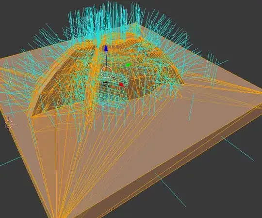

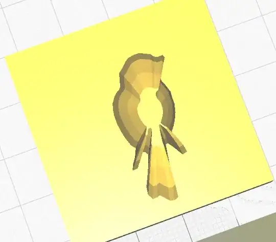

You have modeled your bird. So far so good, but you likely only modeled a single surface and not a closed surface body. The crucial step was forgotten, as your pictures 1 and 2 show: you have designed a single surface for most of the object, not a body. To turn the bird into a printable object needs it not to be a single surface but a surface enclosing a volume that has some thickness.
At the moment, it looks like this: 640 vertices, NO enclosed space.
Model as shared
To achieve an even thickness object in blender:

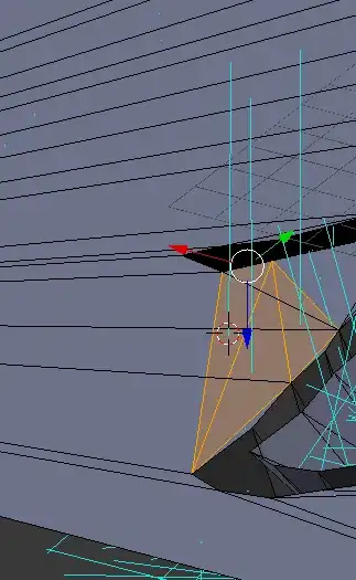

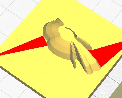

  • CTRL+N to recalculate normals With normals turned visible - spiky = good! Make sure to check the slicer, because we have some strays, visible in red... where are those? They are faces hidden in the body! enter image description here
Hide the underside (Select nothing, allow viewing through the object, 3 > B > draw a box around the lowest layer > H)
If you have the normals visible, you'll see the iffy areas now. Fix them by removing the superfluous faces and flipping those that are not superfuous but just inside out (W>F). One example area I highlight in the next picture This is the inside, we don't want long lines here!
In the end, it should look like this in cura: Hunt for flipped vertices done It slices...

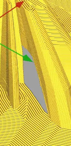

Make sure to check layer view and possibly thicken some areas manually - or make a box-part for the top, so you can ensure printability. As you'll see, at some scales, some walls are too thin due to how we extruded along Z only.
A too thin wall
Alternate ways
As noted in the comments, instead of the Z-Extrude, a model with very vertical walls could benefit from using the solidify modifier. You will have to add it via object mode, modifiers and then choosing solidify and setting a positive thickness. To properly convert the visible modifier into an actual change of the model for the export, you will have to Apply the modifier.
Afterwards, go back to hunting stray internal surfaces and flipped faces.

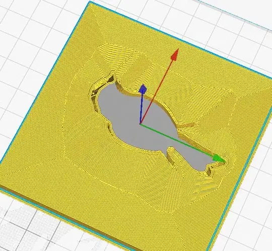

after a lot of search, i used the autodesk Meshmixer to add thickness to the model. I used the blender only for modeling and didn't use the solidify modifier to add thickness to the model. Then in autodesk Meshmixer, using select→ edit → Extrude, i added thickness to the model (the new stl file is presented). It seems that the new model can be printed. However, the blue lines can be seen in the print preview of Ultimaker Cura and i dont know how to remove them. Unfortunately, i haven't a 3d printer to test the model, but it seems that it is printable. the link of repaired stl file
repaired model in cura
the bottom of the repaired model in print preview of cura
sara
  • 71
    The blue lines are moves, there is a tiny gap at the tail end though (the same area I had without throwing a fix over the top part), otherwise, it's a good and working fix. Good job finding a way that works for you! – Trish Jul 06 '19 at 09:53
