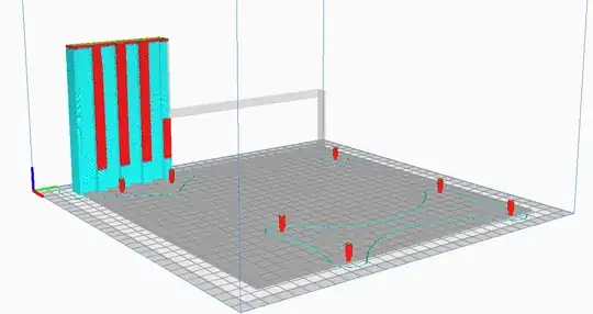

But it seems cura skipped the lower panel entirely when slicing the STL.
Sliced

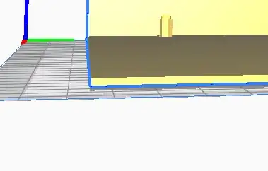

The base is thick, as you can see here, but it is still missing in Preview, and Cura seems to ignore the base.
Base close
I have tried to decrease to 0.1mm for width or initial layer, but cura still ignored the base panel.

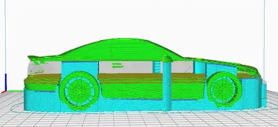

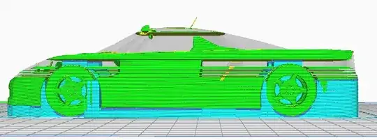

I also found this odd behaviour in a number of my models.. such as this:
Car
or this
Car 2
Notice those missing parts? It is like some parts are floating in the air.
Can someone help me out here? What kind of setting I have to modify?

    often, such models have inverted faces in these areas. look at [this](https://3dprinting.stackexchange.com/questions/5877/black-surface-in-meshmixer/6734#6734) and [this](https://3dprinting.stackexchange.com/questions/10437/problem-in-3d-printing-of-an-empty-model/10449#10449) answer – Trish Dec 20 '19 at 11:39
Using the preview feature as you have is a good method to determine that the original model is flawed. It's not unusual to discover detailed models have reversed normals or non-contiguous surfaces, which will not print.
In a simple example, consider a cube for which five of the six faces are properly described by the design software. This would result in all eight vertices being present, allowing the software to present the "missing" face, but the slicer is unable to create this aspect. The cube is no longer solid and is presented as seven zero-thickness panels, which can't be printed.
It is necessary to repair the broken models, by closing gaps and reverting/recalculating normals, but that requires skill in other software.
Some slicers will attempt to repair damaged models, but some are so severe, the results you've experienced are the result.
If you want a confirmation of a failed model, load it into free Meshmixer, run Analysis/Inspector and expect a "pincushion" of highlighted failures.
    among the softwares that can do so are: Blender (by just doing a recalculate normals) and Meshmixer (which has an automation) – Trish Dec 20 '19 at 11:30
