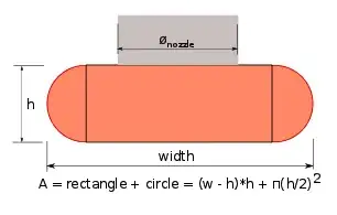

The deposited volume ($V_{extruded_filament}$) of the printed line equals the cross sectional area $\times$ length of the deposited filament path. Area could be defined as taken from e.g. the Slic3r reference manual to be:
Area of a deposited thermoplastic line
Basically (as we apply conservation of mass) the filament volume $(V_{filament})$ entering the hotend need to be the same as the extruded filament volume $(V_{extruded_filament})$ leaving the nozzle; so $ A_{filament}\times E = A_{extruded\ filament}\times s $.
This latter equation can be solved for $w$ by filling out the known parameters. From this calculation follows that for $1.75\ mm$ filament you get a calculated line width of about $0.22\ mm$, and respectively for $2.85\ mm$ filament you get $0.46\ mm$ line widths.
As the nozzle diameter has not been specified in the question, but most commonly used nozzle diameter often is $0.4\ mm$, and modifiers for the first layer are at play to print thicker lines; you most probably have the have the wrong filament diameter set if you have a $1.75\ mm$ extruder setup. Basically it under-extrudes.
