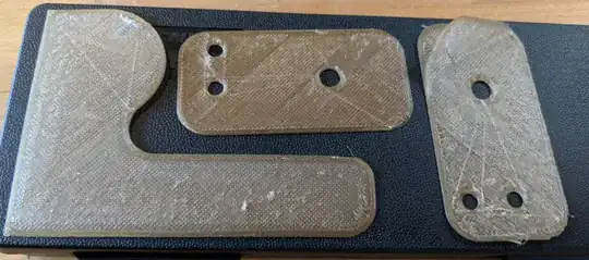

I'm using Cura LE 3.6.9 for slicing. The center item of the three below was printed at 210C, with the most successful at 0.25mm layer height (Cura's default of 0.1mm had far worse results -- not included in the below photo -- with the base layer almost not being there at all; 0.175 did somewhat better).
I'm using the bed heated to 45C, in line with the manufacturer's guidance (that a heated bed is optional, but should be set to 45-60C).
Samples of prints failed after first few layers

  • @Pᴀᴜʟsᴛᴇʀ2, thank you for the welcome! I didn't retain the GCode for every print attempt, so I haven't been able to exactly replicate all my settings; that said, I've added some photos, and what settings I could find. – Charles Duffy May 19 '19 at 23:28

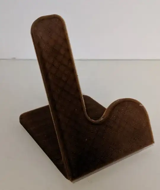

I've managed to get a successful print! The key was to keep the material moving quickly. The settings I've customized are as follows:
  • Print Speed: 70 mm/s
  • Layer Height: 0.4 mm
  • Default Printing Temperature: 215C
...and perhaps not as necessarily:
  • Shell Wall Thickness: 0.8 mm
  • Wall Line Count: 3
  • Alternate Extra Wall: True
Also, I've found it important to print a skirt (perhaps a double-walled one), and watch the first-layer closely and be willing to push more material through and restart: The material in the hotend can easily form a partial clog while the printer runs through its auto-leveling / head-cleaning routine, thus needing to have more material pushed through before the job starts in earnest.
By the way, the model is https://www.thingiverse.com/thing:1993747, by Holodrio on Thingiverse.
Successful print with Entwined
