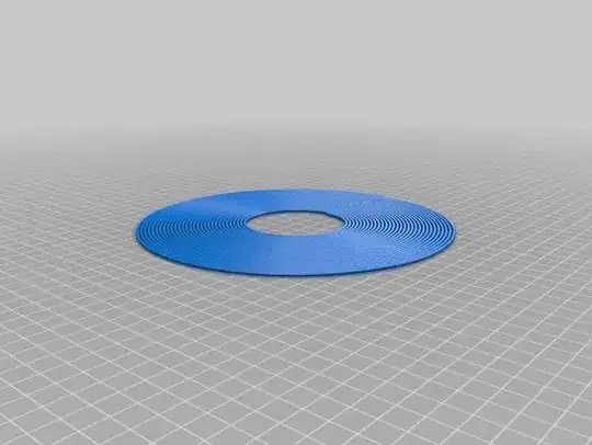

OK, it just turned up on Thingiverse that someone has demonstrated a trivial machine to do exactly what I asked for: any FDM printer.
Its sounds crazy, but it works! This technique will allow you to create one offs, and to color match your 3D-prints.
It works by changing the filament (and the color) of your filament while printing, and this causes a multi colored filament, that can be printed again to archive a homogenic-color.
Rendering of STL file from the link
Source 3D-Printable Filament! -Print Your Own Filament for Multi-Color!, with demonstration video.

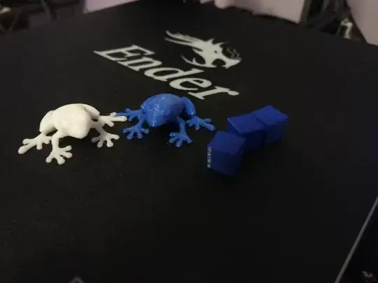

I'm in the process of trying this and it looks promising! The filament:
printed filament
measures 1.65-1.75 mm in diameter and feeds and extrudes cleanly.
The first test print:
mixed filament frog next to unmixed comparison prints
came out somewhat underextruded, but decent, with uniform mixing of color. Mixed filaments were white flex PLA and blue regular PLA, and the plasticizer seems to have mixed as expected too, but the print feels brittle due to underextrusion still. I suspect with some tuning of flow printing the filament, very good results could be had.
On further inspection, the brittleness/underextrusion seems to be somewhat localized, so it likely comes from inconsistent diameter/density of printed filament. This actually seems consistent with what I saw from the slicer output for printing the filament: there were regions at +/- 45 degrees (+ or - depending on layer) in the spiral where it seems like wall gaps differed and extra gap fill material did or didn't get printed. This could be a slicer bug but it seems more likely it's a bug in the model, and I'd probably do better to recreate it myself in OpenSCAD...
