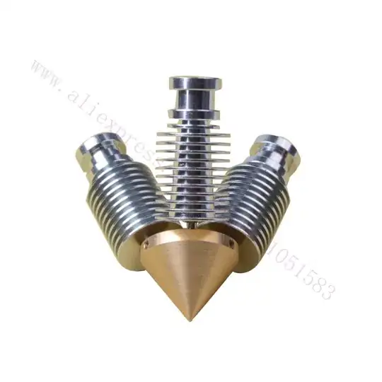

Why is it that we cannot take say a Diamond hotend, or a hotend with 5+ inputs, and mix any color we want? (assuming all the same type, ABSm, PLA). I think it would be interesting to at the least get a gradient effect on prints.

  • Maybe I missed the point of the question, but you can totally do color mixing with a diamond hotend to produce a range of colors -- right now I think they make a 3 way one that allows Cyan, Magenta, and Yellow (like a traditional desktop printer). -- http://www.reprap.org/wiki/Repetier_Color_Mixing – BrainSlugs83 Oct 27 '16 at 23:24

I just started with google and phrase "3d printing color mixing" and on the first place (in fact first two were valueless adverts) I got this Instructables - DIY Full Color Mixing 3D Printer.
How it works?
It uses magenta / cyan / yellow filaments and mixes it while printing with Diamond hotend.
It definitely does what you are asking for and it's exactly the same idea you come up with ;)

  • Perhaps, the actual answer is "nothing is stopping you". -- This is exactly what the diamond hot end is for. -- Here's the reprap wiki guide for doing CMY color mixing with Repetier: http://www.reprap.org/wiki/Repetier_Color_Mixing – BrainSlugs83 Oct 27 '16 at 23:29

As darth_pixel points out, people have had limited success with feeding multiple colors into a diamond hotend and mixing them, but I would argue this is not truly what you're looking for.
The problem is that when feeding multiple filaments into a diamond-style hotend, the colors do not naturally mix completely: if you look at an object printed this way the color changes with the angle you view it from.
This would not be fundamentally impossible to overcome: you could make the melt zone longer, and possibly introduce something to promote mixing (like a spiral path for the molten plastic). However, this would greatly increase the force required to extrude and make retraction near impossible. Both of these issues would reduce print quality.

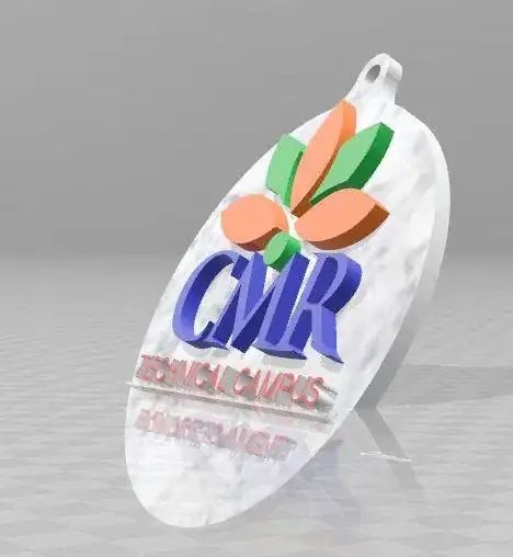

If you clearly observe the geometry of the print it has printed in different colours .the part is designed in such a way that it has the small height gap between the each colour but we cannot seen this gap in one projection plane.. We can print only in direct drive extrusion .by changing the filament of different colours without pausing the print by immediately changing the material . It is printed in single nozzle. The above image clears your doubt.it is designed with different heights.enter image description here
