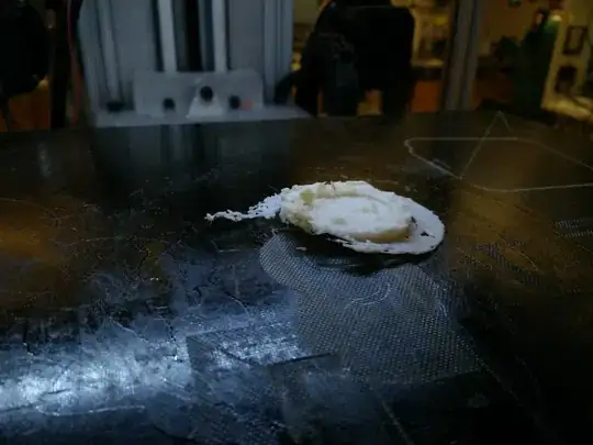

In this following first picture, I attempted with a 240°C tip and a 150°C bed (above PP's Tg). Oddly enough, one side actually looked somewhat decent while the other clearly had trouble sticking. The print speed on this was 1500 mm/min.

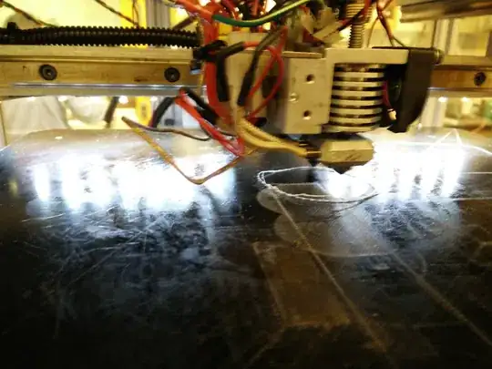

In the second picture, I was printing with the tip at 220°C and a 50°C bed. What's interesting in that print (you may be able to see it) is that the polymer extruded with little blips of material followed by a more stringy section, rather than a steady, even filament. (Print speed on this was 2100 mm/min)
220°C tip and a 50°C bed

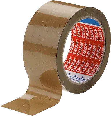

IMPORTANT: apply some cheap brown packaging adhesive strips to the bed, where the part is going to touch the bed, with adhesive facing down. I tried many other solutions but none worked.

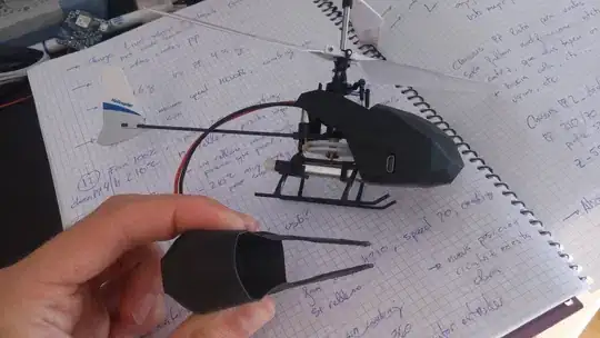

I have printed so far at 20mm/s constant, with 0.2 mm layer heigth, 0.4 mm extrusion width, 0.8mm retraction, flow 125%. Still optimizing setings. Parts come out very nice, with good flexibility and amazing inter layer bonding. Density is a bit lower than ABS, so excellent, and impact resistance is awesome. Check some parts I printed today:

  • Awesome hints, it worked like a charm! I almost gave up on PP after reading Ryan Carlyle's post (which is definitely helpful too), but in the end I had less issues than with ABS. Only thing I changed was 240ºC on hotend, but that may be due to a different manufacturer/material. – Elephantik Mar 16 '17 at 22:28
  • I am using that same tesa brown tape; but it sticking rather too well. Even as I drop the temperature, I cant get the tape off consistently; and its not like this stuff sands very wel... tried another newer roll of tesa tape and its responding rather different; letting go a little better; though still not great. Strange! – Eelco Hoogendoorn Sep 01 '20 at 19:20

First picture clearly shows that temperature was too hight, second one suggests too small extruding speed (too little) which is connected to your printing speed.
35mm/s is quite slow :)

  • I've improved the print a little by increasing the print speed to up to 3500 mm/min, but I'm still having issues. I re-coated the baseplate with ABS, and adjusted the temperatures as well but still haven't got this optimized. Thanks for your suggestions, though I'm not out of the woods yet. – CuriouSir Apr 06 '16 at 18:45
