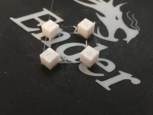

I have some flexible PLA filament (https://www.amazon.com/dp/B00VKSSA4E/, presumably a mix of PLA with some platicizer) that's supposed to be easy to print with settings similar to regular PLA. I've seen recommendations to disable retraction, and indeed I get huge failures to extrude at all for a while after retraction if it's enabled. But with retraction disabled, I get stringing all over the place, and since the material isn't brittle, it's really difficult to remove.
I'm using a bed temp of 60 and print temp of 220, increased from 210 for normal PLA since I had trouble getting it to adhere at lower temp. Printer is Creality Ender 3. Using CuraEngine for slicing. The extruder is feeding the material fine; there's no kinking going on or anything.
Where should I start trying to improve this? Might retraction work with a really really slow print speed or greatly reduced retraction distance? Or are there other ways to avoid stringing?

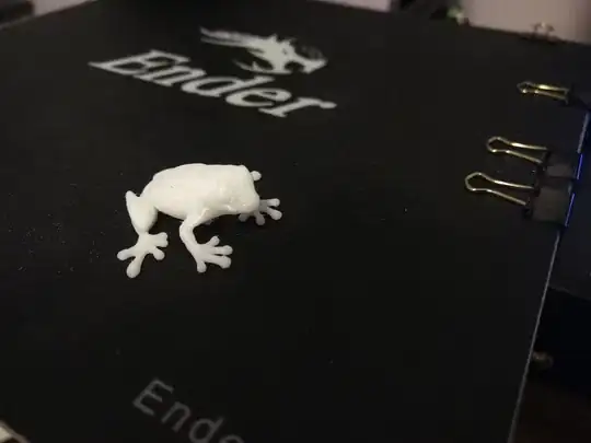

And the results:
test print with no stringing
frog with support, no stringing
frog with support removed

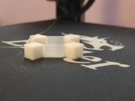

The right path seems to be enabling retraction, but tuning the retraction and print speed settings. I started out by dropping all speed settings to 30. With retraction disabled, this turned the stringing into solid walls between paths, with only a tiny gap at the very start of the wall, right after the extruder stopped:
This suggested that the sudden drop in pressure at the nozzle is cutting off the string momentarily. Back to that thought in a bit.

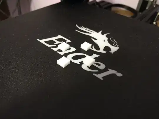

Independently of the pressure thought, I decided to turn retraction back on, but with really slow retraction speed. This helped a lot, but probably not the way I expected; I think what it did was give the nozzle time to ooze at the point where retraction happens, rather than in the travel path. I also turned off infill_before_walls, so that the retraction and potential oozing would happen in the infill region rather than walls, and increased the travel speed way up to 200 to take best advantage of the moment where oozing is interrupted.
At this point, I'm getting almost-acceptable results with retraction_retract_speed set to 5 (vs default 25), default retraction amount, and speed_travel of 200:
