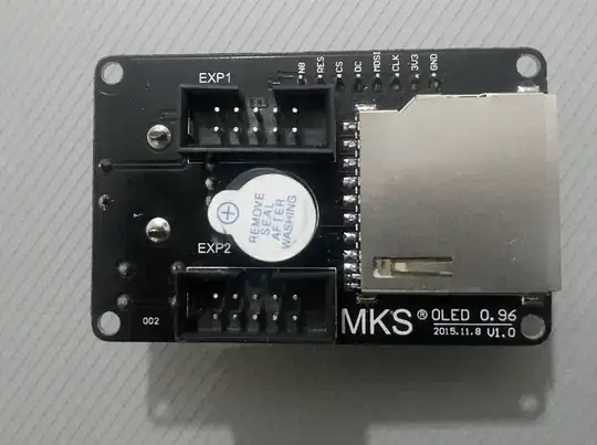

  • Maybe you need to set more constants? E.g: #define U8GLIB_SSD1306? Also post a picture of your module front and back, e.g. is it exactly the same? – 0scar Feb 12 '19 at 20:44
  • if I uncomment that too,it says: #error "Please select no more than one LCD controller option." – 2012User Feb 12 '19 at 20:54
    Are you aware that your module is different than the MKS from RepRap.org? You have a 0.96" display, the MKS is 1.3". – 0scar Feb 12 '19 at 22:54
    AFAICT, he has a https://www.reprap.me/mks-12864-oled-0-96in.html – Trish Feb 13 '19 at 00:11
First of all let me state that I do not own the module! The analysis below is based on old patches that worked in a version of Marlin in 2015, and translated to the latest version of Marlin of the 1.1.x branch. This is 1.1.9; this is the last version of the 1.1.x branch, all new development takes place in branch bugfix-2.0.x (dated May 2019).
The reported patches are compatible with an earlier version of Marlin Firmware (a version from 2015). Clearly this doesn't work anymore, but that should not be a problem, if it worked then it should work now provided we configure it correctly. The display you have requires U8GLIB_SSD1306, so the U8GLIB library need to be installed in your Arduino IDE!
Let's follow this installation guide for the older version as an example.
First, from patch 1 it becomes clear that you'll need to define that you are using a display that is identified by its name/type, you should uncomment the following line in your configuration.h in the section:
//======================== LCD / Controller Selection =========================
//========================   (Character-based LCDs)   =========================
//#define MKS_12864OLED_SSD1306  // Uses the SSD1306 controller
to:
as you are using the SSD1306 controller according to this reference.
That is about the only thing you add in the configuration.h file! You only activate the name of the controller type (as in defining a constant) so that it is caught in other source or header files to do/trigger something.
