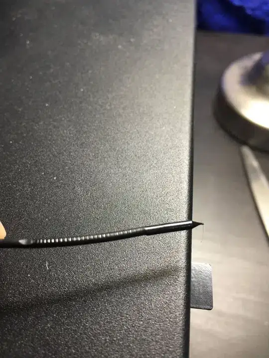

So here is my problem, after about 200-300 mm of extrusion, the PLA stops coming through the nozzle. When I pull the PLA out it looks like this. There are teeth marks going up the PLA and end with a small divot. The head of the PLA is slightly thicker than the rest of the PLA; approximately 1.9 mm.
Filament shape after taken out of hotend

Looking at the tread pattern on the filament, I think it's getting stuck. Note that the teeth marks get closer together as you go up the fillament, and the last one is a big divot, that looks like the gear trying to grab at it, and being unable to move it.
Are you seeing any drops in nozzle temp? I had a cooling fan kick in and drop temps low enough to prevent extrusion before.

From the discussion in the notes, heat creep was identified as a possible culprit, and seems most likely.

    Alternatively - it could be heat creep. If the filament gets too soft by the gear, then it gets harder to push the filament down, and at some temp, impossible. – kolosy Feb 12 '19 at 20:28
    so, i might have just fixed it. Im doing a test print to see. I think the culprit is heat creep. When I put the print head back together I put the heat sync on backwards. (smart, i know). I think because the heat sync was on backwards it wasnt dissipating the heat as well, so i was getting melt higher up the PLA, which made it too fat to be able to continue extruding. This explains the pattern on the PLA as well. – Nate4436271 Feb 12 '19 at 20:29
  • That would definitely do it. – kolosy Feb 12 '19 at 20:41
    Did a few test prints and they came out successful! Thank you so much. I guess the heat creep softened the PLA which made it bunch up on one side and made it so that the teeth couldnt push the PLA down. – Nate4436271 Feb 12 '19 at 20:56
