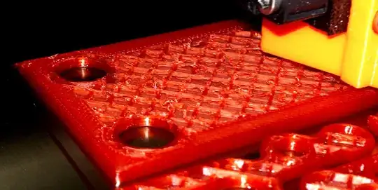

My i3 MK3 is printing very well for solid parts of an object, but it messes up with infill.
Infill rough
As you can see in the image, the infill is broken into pieces and bends to that the surface becomes rough and the nozzle touches it next time it moves there, which probably does not make things better.

I'm printing with 20% infill and I believe that this worked before at the same speed, so I'm tempted to say that both remaining options are options, but it should work without them.
It also seems to me as if the infill is thinner that ordinary walls. Is the extrusion speed lower in case of infill? Is there a way of changing the extrusion speed for infill?

    how does the infill print speed compare to the perimeter print speed? If the infill speed is appreciably higher you will have failed bonding between layers, which is somewhat how it appears in the image provided. PETG likes reduced cooling, from my understanding (limited) which might also point to cooling fan speed comparison. – fred_dot_u Feb 11 '19 at 22:22
From your comments can be read that you print infill at 200 mm/s.
Know that 200 mm/s is ridiculously fast (like high travelling speed), close to the limits of printing on certain machines (for an AtMega)! It is hard for the filament to keep up at this speed. A value of 60 mm/s would be a good value to start experimenting. Your infill is not rough, it just failed printing. I have printed kilometers of PETG, normal print speeds for my PETG are recommended at 30-50 mm/s by my manufacturer; I get good results at 50-60 mm/s. On my Ultimaker 3, 70 mm/s is also feasible.
Note that the filament you use seems to have rather low printing temperatures (195-225 °C) as opposed to the PETG filament (co-polymer) I'm used to. The manufacturer does not specify advised print speeds (other than "high", but what defines "high"?), but this user posted some of his print settings for this material. The overall speed of 60 mm/s seems to support lower than 200 mm/s print speeds.

    60 mm/s improved much. 50 mm/s is almost perfect. Great to see that I don't have to decrease the overall printing speed. – Thomas Weller Feb 12 '19 at 11:59
I have dealt with this on infill as well on multiple MK3s.
However, it was not the speed itself, but the hot end having difficulty extruding enough to keep up with the infill.
Some things to try:
  • Raise hot end temperature 5 degrees (melt filament faster)
  • Lower infill speed, it will not affect your overall print time very much (surprisingly)
  • A combination of the two above.
Good luck!
