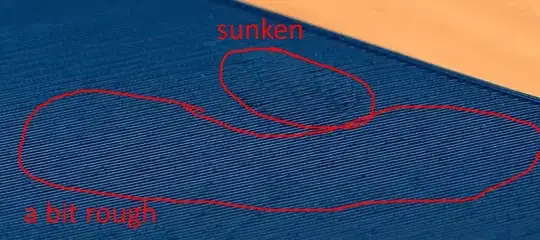

Photo from part A (RPi case top piece):
rough and sunken

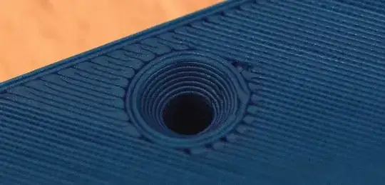

Photos from part B (RPi case bottom):
There is a really ugly screwhole (sorry for the blurry picture):

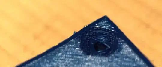

But in the same part, there's an almost perfect much better screwhole:
Perfect screwhole

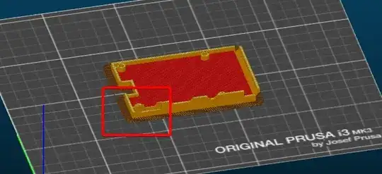

For the location on the print bed, it's here (both parts):
Problematic region

  • You print pretty hot, and the gaps between the deposited filament lines give the impression that the nozzle is not close enough to the bed for the first layer. What type of adhesion on the bed are you using? Please update the question. – 0scar Apr 16 '19 at 20:00
  • Agree with @0scar on the heat. Also, even on the "good screw hole" it appears there are irregularities. In the image, at 10 O'Clock of the screw hole, it is rather squished, while directly across at 4 O'Clock (and above it on the longer passes), the extrusion is quite a bit longer and thinner, with some gaps showing. It just doesn't look *equal* as I'd expect. Maybe I'm out in the weeds and the image doesn't do it justice, so just kinda throwing this out there. – Pᴀᴜʟsᴛᴇʀ2 Apr 16 '19 at 20:07
  • @Pᴀᴜʟsᴛᴇʀ2: that's true. It's flatter and smoother when the lines are shorter, such as in the squished area. It's thinner on long lines. This would mean that I could try to lower the speed of type "solid infill" (pink in Slic3r) like [I did for PETG](https://3dprinting.stackexchange.com/a/8233/1570). Maybe I should apply that for all presets. – Thomas Weller Apr 16 '19 at 22:12

I know you said you don't want to change the Z height, but it does look like you're printing a bit too far from the plate. I would recommend adjusting your Z-offset if you can, or adjusting the limit switch (or whatever your Z-homing mechanism is)

Definitely the corner of your bed where print was worse is slightly unleveled (a little too low), because if you look the hole, it has artifacts too, probably because the nozzle was depositing the melted filament from a higher distance than on the "good" part.
You can see later in that hole, that the layers finally catch up with the rest, so:
  • You need to correct the bed leveling on that corner (too low)
Also, the better part doesn't look right either. You can see the ring around the good hole doesn't close because the filament din't stick at the beginning of the circular movement. Plus, your first layer should be smoother than that, not wormy-like.
To experiment how to get a better first layer you need to tweak in very small amounts:
  • The first layer height (I may need to be lower for you)
  • The temperature (I don't think you need more temp for your first layer, probably the fans start blowing after the second layer anyways)
  • The % of extruded material (you may increase it in very small amounts only for the first layer [and only after a lower layer height didn't worked])
  • The speed of the first layer (it may need to be lower. imagine your nozzle is trying to print with chewing gum and what would happen if speeds are too high, PLA has a rubbery consistency when melted)
