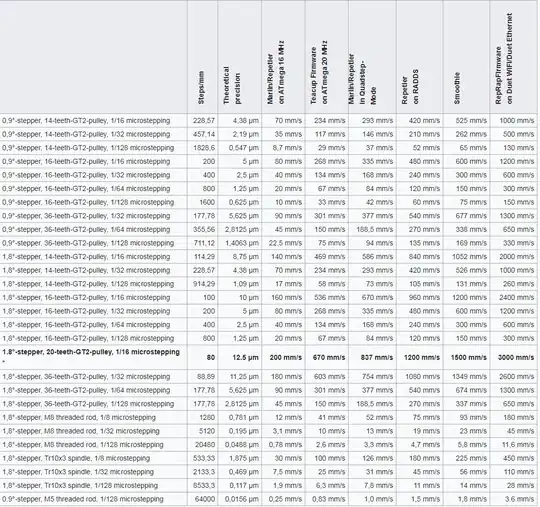

This reference gives you some more background as well as a table (which is a little optimistic for Marlin firmware) with maximum speeds. Depending on the application in your printer (stepper type, pulley size and microstepping value), it lists some maximum speeds for various boards: Table of maximum travel speeds
What is maximum safe travel speed?
In case of an Anet A8, 1,8°; 16-teeth-GT2-pulley; 1/16 microstepping, this leads to 160 mm/s on Marlin on an Atmega microprocessor (note this is optimistic).
