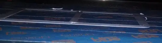

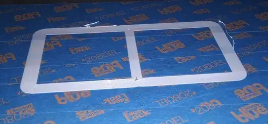

I've been having some bed adhesion problems that I have been trying to solve by leveling the bed. I think that it's pretty level now but when I start a print the lines seem pretty flat. Is this true? I used a feeler gauge to have a 0.2 mm gap between the bed and nozzle, but the center feels as though there's more space, despite the tape (ie I didn't feel any resistance when leveling the center) so I'm not sure if the plastic is too squished or not.
Top View Side View
I am printing PLA with 210 °C at Nozzle and 60 °C on bed. I also used a 130% extrusion factor for the first layer on a Creality CR-10S. It did come without a black print surface but with a glass sheet and a roll of painters tape instead, so I opted for Blue-tape.
Also, I see some stringing, which seems to happen with skirts and brims (this is my first brim) and a bit of under extrusion in the center. But those are probably concerns fit for a separate question.

No, the bed does not look too close to the nozzle, it could well be that it is too far from the nozzle. However, the brim looks okay, but the method you follow is questionable.
Using a feeler gauge of 0.2 mm is larger than the recommended paper method which is in the order of half that value (0.1 mm). You compensate this larger leveling gap with an over-extrusion of 130 %. The preferred method is using a thinner feeler gauge or a sheet of paper without over-extrusion. The reasoning is that if you have a 0.2 mm to start with, adding the first layer thickness (e.g. 0.2 mm) would imply that you are already starting at a 0.4 mm gap on your first layer. You now try to push out more filament to fill that gap (resulting in not really pressing the filament to the plate).
Furthermore, your tape does not look like it is laid down next to each other, it looks as though it is laid over each other. This creates an uneven bed surface.
Finalizing, you should do whatever you do to get the filament to stick to the build plate, if it works for you, use it. If it doesn't produce viable prints, or you are not satisfied with the surface finish, change it.

After clarifying the printer type and specs, I have to go d'accord with 0scar's answer about the bed leveling thickness: try to go down to 0.1 mm.
About the bed adhesion I have a couple of pieces of advice though:
  • Go with what works for you (Rule #1: Never change a running system)
  • Try out the bare glass bed coated in...
    • Gluestick left to dry a little (that is PVA!)
    • a super thin layer of Wood Glue (also PVA)
    • Hairspray (also PVA)
    • 3D-Lac (PVA again)
  • When sticking with tape (pun!), lay it down side by side with no overlap. Wider tape is better.
    • try different brands of tape, I prefer the rougher surface tapes
  • don't fear to use your heatbed! 60°C is the common PLA print bed temperature.
    • if you can, take a thermosensor/thermometer and check what the temperature on top of the glass actually is: you might need to adjust the heater setting up to get a bed surface of 60°C.
