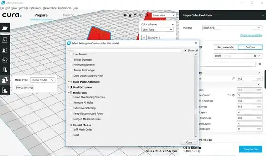

At the time of writing this answer, the image below shows the Ultimaker Cura interface for "per model" settings, basically different settings with respect to the other models. As can be seen, you cannot expand the Build Plate Adhesion (it already shows the arrow downwards, so expanded):
Ultimaker Cura with per model settings

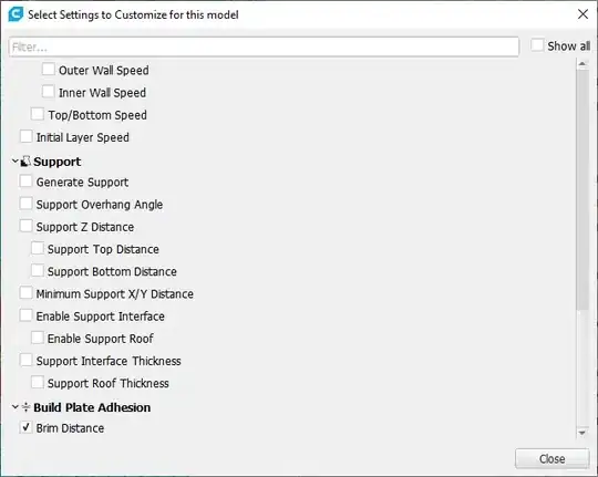

But, yes as of Cura 4.5.0 (see this answer) the "per model" settings have changed and the Build Plate Adhesion is added with the option to add a Brim Distance to trick Cura into de-attaching the brim (it will print a brim, but it is not attached to the part):
Cura 4.8.0 per model settings example

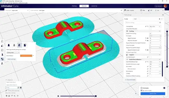

When applied to several models this could result in models with a brim attached and others without the brim attached:
Example showing brim attached and detached
