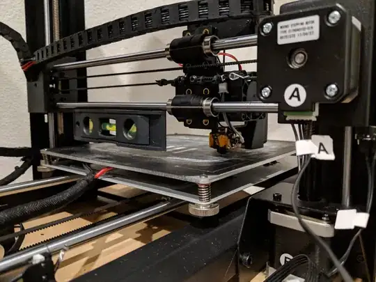

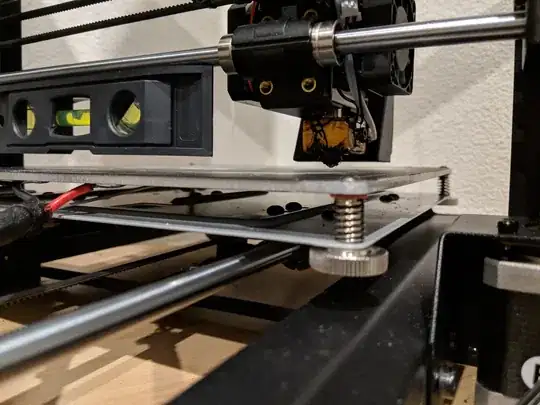

you can see the z-limit-switch in the right of this pic next to the letter A's pic1 you can see my extruder still has some distance to go before reaching my print bed but you can also see that my screws are loosened as much as possible pic2 showing the horizontal extruder bar is now leveled pic3

  • Kane, your portal is not level ut shows clearly to be tilted downwards. – Trish Jan 06 '19 at 10:23
  • @Trish what do you mean by "portal"? – kane Jan 06 '19 at 14:48
  • The last picture show me, that you have a tilted X-axis portal - the bubble should be in the middle of both lines, it is to the left side. You might want to brush up your spirit-level knowledge... http://www.johnsonlevel.com/News/SpiritLevelInformation – Trish Jan 06 '19 at 16:59

The bar where the level is attached is the support cross-bar for the X-axis travel.
It's important this bar be level, but it's even more important the bar be true to the rest of the machine. We call this "leveling" the printer, but really the more accurate term is "tramming". If the bar is level, but the machine sits on an unlevel surface, things are out of sync. This may be the case here.
I did this by unplugging the wire to one motor and modified the z-position so that the other connected side would go up. (Is this the proper way of adjusting the horizontal bar?)
No. The first image in your question shows two threaded vertical rods: one on the left that is exposed, and one on the right that is more hidden (only a small portion is visible between the two "A" labels). These rods control travel in the vertical "z" direction. Each rod has an inline coupler connecting it to the Z-stepper motors. The coupler for the right side is visible just below the square label "A". You adjust the level of the X cross-bar by turning the couplers while the printer is turned off or the motors are otherwise disengaged. This allows you to make finer adjustments for the bar, often without needing to re-home the Z axis.
You can also use this method to correct your immediate problem.
I own a Select Plus, which uses similar construction to your Select V2. When I first got the printer one of my couplers was not adequately secured to the rod. This made for all kinds of difficulty leveling the bed at first, including at one point an issue similar to what you are experiencing.
Re-leveling the X cross-bar is easiest if you are first certain the printer itself is on a level surface. If this is the case, you should be able to use the level in the images to check the cross-bar in the same way you did previously, making adjustments via couplers. But check that surface first. If the surface is not level, you need to adjust the X cross-bar to be parallel to something in the machine other than the bed. While we want the bed to match the rest of the machine, the very fact you can adjust this means it's not guaranteed at any point in time, and so you should use something more structural to compare against.
In this case, you can place the same level across the two steel Y-axis travel bars below the bed, and check where the bubble sits. Then make sure the bubble ends up in exactly the same position for the X cross-bar, regardless of whether or not that's level to the ground. The greater precision you can get here, the better things will be.

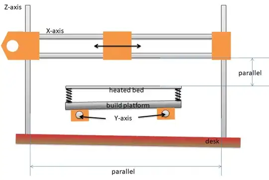

For leveling your bed you do not require the use of a bubble level! This is not necessary, if you do, you need to place the printer on a bubble level underground. It is far easier to level the bed relative to the printer frame rather than to the outside world. Basically the bed and the X-axis (the axis that moves your nozzle) need to be parallel and each side of the X-axis needs to have the same distance to a reference point on the frame.
In order to level your X-axis you need to position both of the sides at a certain, same distance from a reference point on your frame, e.g. you could measure this with respect to the top of the Z stepper attachments. If you have 2 steppers, it is easy as you can individually move them by turning the lead screw when the stepper motors are not powered. Once you have each side at the correct distance you can commence a homing sequence and start leveling your bed.
