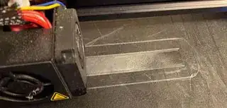

The first sign of trouble in paradise is that, after two layers of a simple rectangular base for a Galton Board I'm trying to build that uses sand, the right side is clearly thinner than the left:
This is with a translucent Overture PETG filament, 1.75 mm.

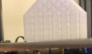

For the board itself, which is about 15 cm tall and looks MUCH better if printed vertically, I notice after about 3-4 cm that the bottom of the left side is becoming detached from the bed:
This gets progressively worse as the print goes on:

The uneven level is explained by the unfortunate choice of the printer manufacturer to not have a second Z lead screw. It is pretty difficult to level these printers, it is all a combination of the correct X belt tension and roller tension. The uneven level in the first picture is what is causing your print to detach, As can be seen you've got a lot of "squish" on the right side, but less adhesion (seen by the less transparent color) on the left, therefore it would fail on the left.
