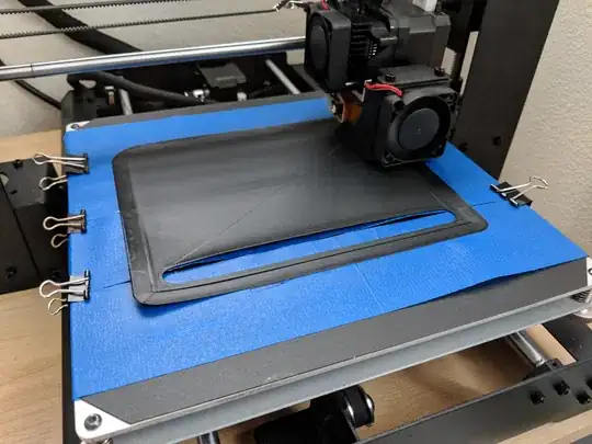

I have a few issues with the blue tape, which I'm trying out for the first time.
The tape seems to warp, bubble and lift from the aluminum plate when it heats and cools and during printing. I put some clips on it, but not sure if this is standard.
It also seems the print is lifting off the tape itself (bottom left corner). I applied some magigoo glue to it. Maybe I shouldn't have done that.
I feel like this print isn't going to make it...
Print and tape adhesion problems
I'm printing with a Monoprice Select V2, with AmazonBasics ABS with 100 °C bed and 250 °C extruder temperature, at 15 mm/s initial layer speed and 60 mm/s print speed sliced with Ultimaker Cura.

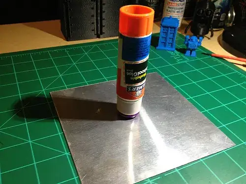

My Dad uses prittstick on the bed before the print and the bed keeps the prittstick just abbout the right temp for it to stick.
Me Gluing his print bed (No Need FOr tape)
  • PRetty much any brand gluestick will work this way. The only potential drawback is sometimes you have to scrape glue off the bottom of the finished part. – Carl Witthoft Jan 02 '19 at 13:55
    @CarlWitthoft Most, if not all, glue from those sticks is water-soluble. Genuine Pritt stick glue has been [biodegradeable since the year 2010](https://www.henkel.co.uk/spotlight/2019-07-19-celebrating-pritts-golden-anniversary-963874), so it should be ok to wash it off under a running tap. – Andrew Morton Sep 11 '20 at 18:46
  • @CarlWitthoft quick fix is to wash the finished part. All the gluestick I have is water soluble and it washes off easily with water and some finger rubbing. – Criggie Feb 19 '22 at 22:21
