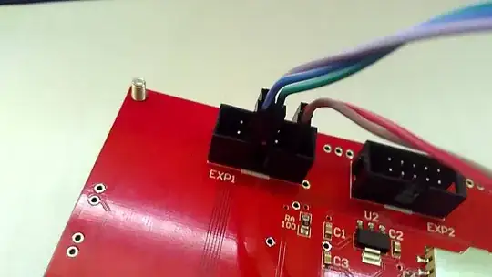

This implies that you need to attach the correct pins on the Arduino (in my case to digital pins 6, 5 and 4 for respectively SCK, MOSI and CS to the respective EXP1 pins 5, 3 and 4):
EXP1 wiring for Arduino Uno
Jumper cable wiring full graphical display for testing purposes
Note that you see 5 pins attached, as the LCD needs to be powered (pin 10 on the EXP1 header) and grounded (pin 9 on the EXP1 header).

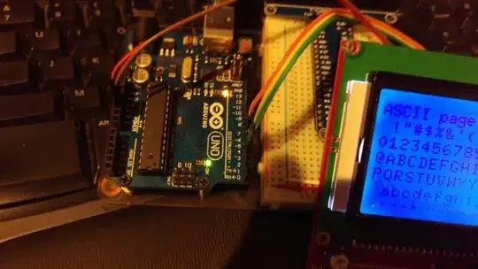

RepRapDiscount Full Graphic Smart Controller connected to Arduino Uno clone running U8GLIB "GraphicsTest"
I wired this on an Arduino Uno clone and confirmed that 2 of the spare RepRapDiscount Full Graphic Smart Controller clones showed the test program.
PS, this is a simple wiring of the LCD, it displays the test in fade blue-ish, so not the bright colored white pixels, but that is normal!
