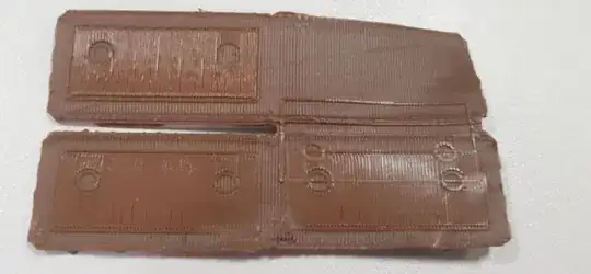

UPDATE: Image has been attached of the failed part, excuse the colour, I use it for my test prints. This is orientation it printed on the bed. First 3 blocks printed fine, 4th one jumped It printed in the following order 1. top-left, 2. bottom left, 3. bottom right, 4. top right.

  • Can you verify that the extruder head has moved up (Z-axis)? It's unlikely but possible that the head is running into the extruded raft, causing a drive jam. Try printing something with a brim instead of raft and see what happens. – Carl Witthoft Dec 05 '18 at 16:14
  • @Carl Witthoft Unfortunately the z-axis moves fine, As you can now see in the image I attached, it printed the 3 first 3 blocks with no problem (1. top-left, 2. bottom left, 3. bottom right, 4. jumped on top right). I will try printing without a raft when I get in tonight see if that makes a difference. – David Gebbett Dec 06 '18 at 09:01
  • Hmmm, in addition to Oscar's answer, I wonder about this sequential print approach. You will have less risk of collision with the material if you set to "print all at once" so that all extrusion at a given Z-height takes place over all 4 blocks in one sweep. If that is what's going on, apologies for misinterpreting your description. – Carl Witthoft Dec 06 '18 at 13:09
  • @CarlWitthoft Sorry yes that is what is happening. I should have been more clear, the order I gave is the order it printed the first layer – David Gebbett Dec 06 '18 at 14:30

Looking closely at the image, you will see that the infill of the first layer does not touch the outer lines. This could be a hint that your belts are not tight enough (mechanical issue). Too loose belts cause the stepper driving pulley to skip. Also check the pulley whether it is securely fastened so that the pulley is not slipping when subjected to an increased torque. The nozzle most probably hits the raft (ABS? as it curls up and detaches, you see some irregularities on the left of the bottom right product in your image). Do note that too tight belts are also not wanted as they stress the stepper by an increased torque load. If the issue is electronically related, you could thick of increasing the torque by increasing the current through the stepper (and driver). Too much current will overheat the stepper driver though, so make sure that these do not exceed their rated maximum and properly cool the stepper drivers.
