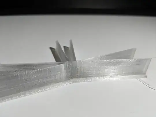

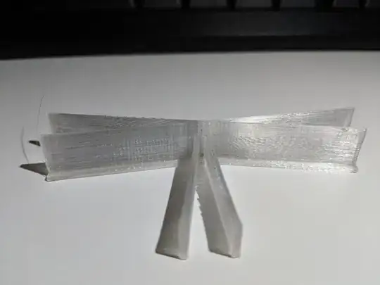

My test print to replicate the issue. The ripple bit is brittle and under extruded.
Test print - Image#1
Test print - Image#2

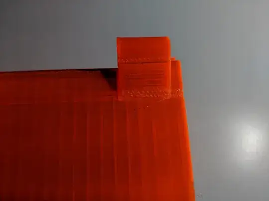

This was a Prototype piece for an up-sized print I was planning. After going around it under extrudes at the same point each time 210 °C
Prototype piece

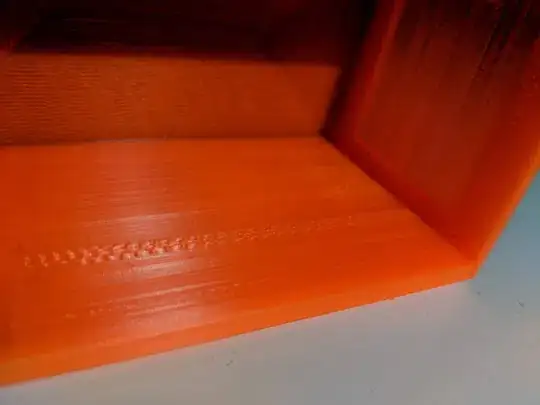

Most of the print is fine just some parts are different. This is an inner wall.
Inner wall
