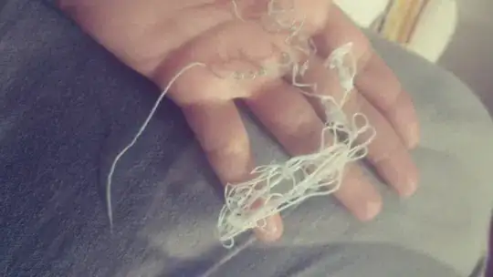

I recently bought the Anet A8 from Gearbest. Everything so far seems in order, but one big problem.
No matter which filament I used (PLA and ABS), the result is always like this:
Failed print
In the picture there are the PLA and ABS I've been trying to print. What I tried to actually print is a simple arrow.
One of the things that caused it was manually trying to push the filament, because the extruder gear doesn't really push it. It doesn't seem like it's stuck, but it just won't move. Then I move it manually, it does this.
I have tried different methods for the gear to push it and different printing temperatures (first the presets, then PLA 190°C / ABS 240°C) but it does the same thing.

  • What temperatures have you tried at the nozzle? – Pᴀᴜʟsᴛᴇʀ2 Nov 25 '18 at 01:15
  • Help us help you! We often need to know extra information, in this case: What is your nozzle temperature and have you leveled your bed? The effect you get is sometimes called "spaghetti" by makers. – Trish Nov 25 '18 at 02:31
  • Thank you very much. At first I didn't change the setting of the heat, then tried 190° and 240°. The only thing that showed difference is the smell. As fpr the bed, I didn't touch the setting (And not really sure how and what). – Jeanne Nov 25 '18 at 06:13
    did you Level the bed? check https://3dprinting.stackexchange.com/questions/470/bed-leveling-method?s=2|38.8574 - you might have jsut too much distance between the print surface and the printhead, resulting in 0 adhesion. To check: home your printer, then order a move of ca 30mm on X and Y and take a picture from the front of the printer with a white backdrop. – Trish Nov 25 '18 at 12:32
