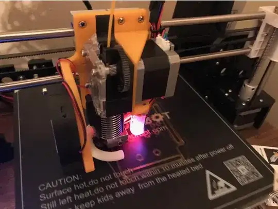

Working on getting my Anet A8 upgraded with some extra toys and although the sensor works, I can't get it to home correctly. I'm looking for some assistance to home the X in the center.
The probe is working and showing results, but when homing, it does not home to center (SAFE_HOME is turned on, Y homes to center but X is about 3/4 from endstop) and the Z offset always reports as 0 when using M851. There is a clear gap of about 10 mm between the bed and the nozzle after G29 is ran.
I'm using the following mount: View of the Anet A8 with alternative mount

Your sensor offset for the X direction is incorrect.
#define X_PROBE_OFFSET_FROM_EXTRUDER -28 // X offset: -left +right [of the nozzle]
should be
#define X_PROBE_OFFSET_FROM_EXTRUDER 28 // X offset: -left +right [of the nozzle]
The hints in the comment already suggest that (left is negative, right is positive), your touch sensor clearly is located on the right side, hence +28 mm.

    Thank you for your comment, that was really useful. I've got the probe centered now, and am trying to work out the probe map from the other link you provided. – NXSmiggy Nov 21 '18 at 15:37
  • @NXSmiggy You're very welcome. Probe area is pretty easy for your printer as your Y offset is zero! Good luck, and please come back, we're here to answer your questions. – 0scar Nov 21 '18 at 18:56
  • Had to modify the probe values as needed to relocate the probe. Turns out the 3DTouch is 3mm longer than a BLTouch so fails to stow beyond the nozzle height. Good job i noticed before crashing my nozzle + probe into the bed – NXSmiggy Nov 22 '18 at 13:59
