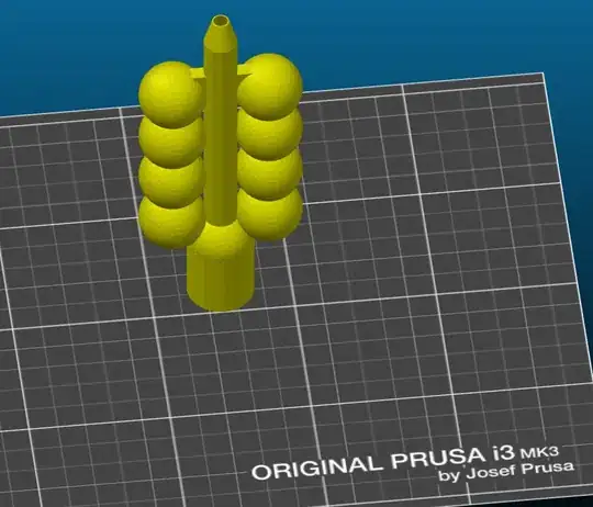

This is how I have it in Slic3r:
Ferment Air Lock in Slic3r

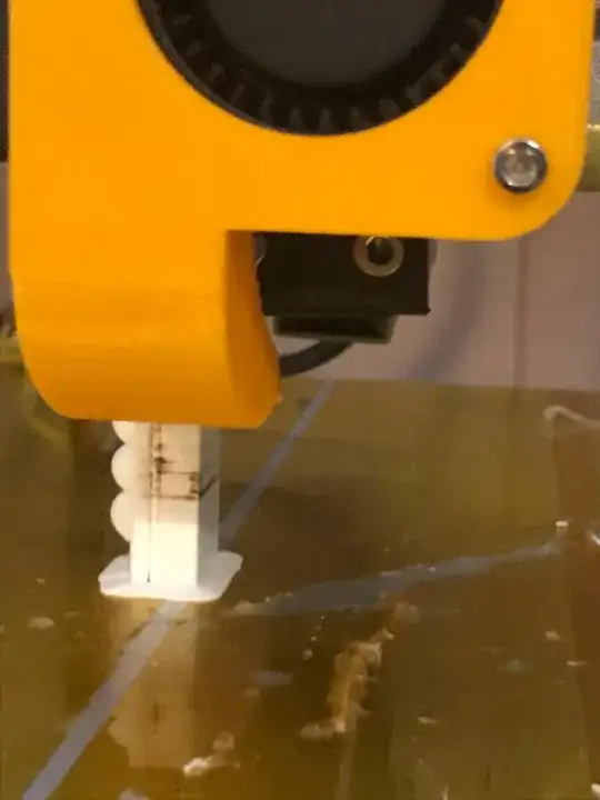

When I print it I get this horrible form and I have to stop in order to avoid waste of material.
Bad print

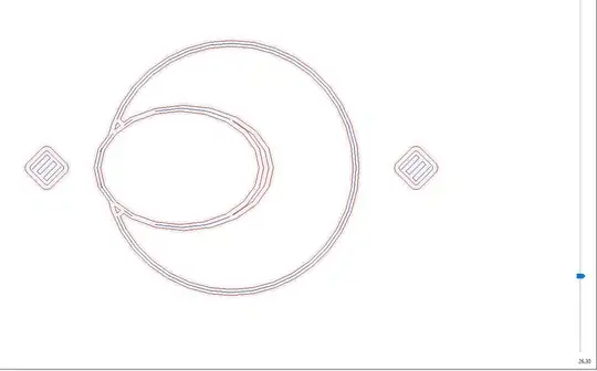

When I look in the layers tab and then scroll up to see layer workflow I can see this:
Layer workflow
So that means is trying to print like in the "air" something without any support.

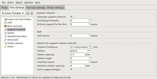

You need to put a check mark to enable supports in Slic3r as you cannot print in mid-air.
This option is found under "Print settings" with header name "Support settings". Please look at the Slic3r manual for more options.
Slic3r print settings
