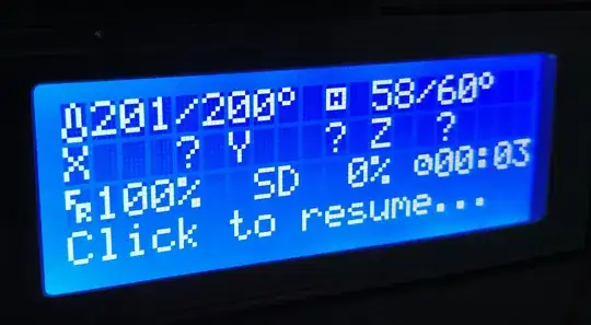

I have a long print that keeps aborting. At some random point mid-print the printer says "Click to resume...". There is nothing in the G-code that asks for user confirmation. What could it be that triggers this? I noticed that sometimes (not every time) there is a blob of plastic in the way that should not be there.
On one occasion, after the "Click to resume...", the LCD showed the message FY178.N16466 and again waited for a click.
The printer is an Anet A8 with Marlin 1.1.9. Slicer is Cura. I am printing via USB from Cura directly.
This is the error message:
"Click to resume..." error message

    It appears to be a problem between Ultimaker Cura 3.4+ and Marlin Firmware 1.1.8+, where Cura sends too many M105 commands (without waiting for an OK) causing the buffer of the printer to overflow, see my updated answer. – 0scar Nov 06 '18 at 07:19

To answer your question directly, this action (Click to resume...) is triggered by a buffer overflow of the Marlin firmware that is caused by the repetitive sending of M105 command by Ultimaker Cura (without checking the result).
This problem is a reported problem and fixed in the next release of Ultimaker Cura (please do note that as of posting this answer, the 3.6 Beta release is available for download). It appears to be a communication problem between Ultimaker Cura 3.4+ and 1.1.8+ versions of the Marlin firmware and has to to with polling of the temperature (M105). The link above also states it is fixed in the 3.6 release (which is the next release) as the fix has been integrated in the main code base.
This describes the problem:
To update the temperatures in the monitor, Cura sends M105 pings every 2 seconds. It seems that if this is done during a print without waiting for an OK from the printer, the serial buffer on the printer may still overflow eventually (causing Marlin to complain/pause).
and this describes the solution:
During some operations, such as preheating, the printer responds to new commands with echo:busy. While it is busy, it does send temperature messages, but these are not prepended with an ok, because the ok is supposed to show that a command was received and executed. So the two patches I wrote do the following:
  • the pattern matching no longer looks for ok messages, but looks for temperature updates (this fixes the temperature updating while the printer is preheating)
  • once the printer has said that it is busy, stop asking for temperature updates until the next ok is received (this prevents the serial buffer overflowing while preheating)
