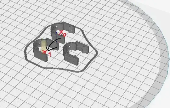

I have a delta printer. The problem is that after the start gcode is executed and the extruder head is 15 (Pic: x0) mm above the center of the plate, the first move towards the start (x1) of the actual print is performed at (maximum possible?) speed @ infinite acceleration. After that the print is performed with regular acceleration. This can cause missing steps.
The problem seems to arise after the start gcode section. How can I fix it. I use Cura 3.5.
