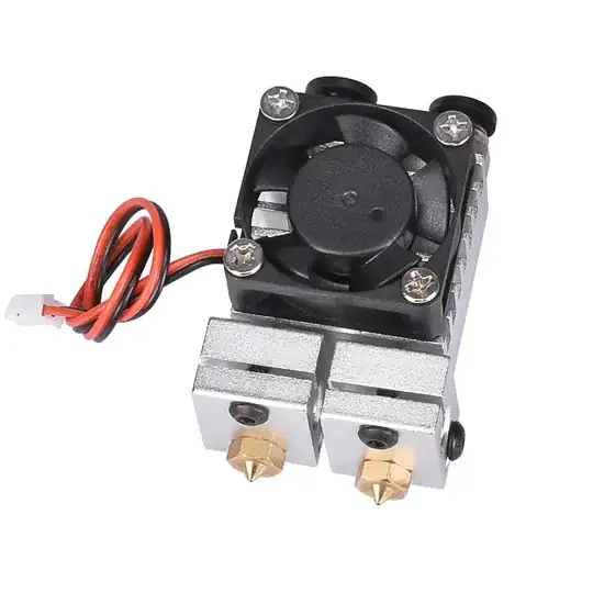

It appears (now confirmed in your question) that you are using a Chimera 2-in-2-out hotend like depicted below:
Chimera hotend 2-in-2-out
Chimera hotends generally use all-metal heat breaks (not confirmed yet) which are harder to operate than "normal" PTFE lined hotends. A common problem that happens is that heat creeps up causing problems as a result of too slow printing or too high retraction length settings. Basically your problem is clogging related to all-metal heat break printing. This is recently asked in this question: "Apparently systematic nozzle clogging". Please read the answers to that question as they describe very well what happens and what to do.

In your case this could well be a cooling issue in combination with a too high print temperature and a possibly too high retraction length setting (depends on the length of the Bowden tube). The fan you mounted in the front (onto the cooling ribs, so the rightt fan in your image) is too large for this hotend. You attached the fan to the left top mounting hole so that it exceeds the right and bottom area of your cooling ribs. Furthermore, this larger fan has a larger center (hub) to house the bigger engine so that you end up with a lower cooling flow for at least the right extruder as most of the cooling ribs area is blocked by the fan hub. Please fit a fan that fits this hotend. Printing a fan adaptors may not work as well, these fans have a very low static pressure difference, so a convergent duct may not work as well as you might think. Considering your temperature you are printing PLA; PLA could usually be printed well in the 185 - 195 °C temperature range (depending on the PLA), 210 °C seems a bit on the high side.

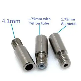

Another solution could be replacing the heat breaks for lined heat breaks: Different types of heat breaks for the Chimera hotend
