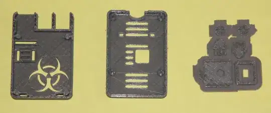

A Monoprice Maker Select V2, upgraded incrementally with a Micro Swiss all metal hot-end, machined lever, and D4 extruder gear, systematically fails to produce complete prints, as seen below:
Incomplete prints

  • The nozzle clog appears at different heights/elapsed times, so it does not seem to be because of heat creep, which ought to take the same time to take effect, each time.
  • All the clogs so far have been easy to clear manually, once the hotend has been made accessible.
  • The filament (1.75 mm PLA) is quite new, has only been sitting on the spool at the top of the printer, seems regular in density, is not visibly damaged etc.
  • In the original configuration, before the upgrading, the printer worked fine for some months.
One possible explanation might be inconsistent temperature in the extruder, but the display does not show any great variation.
Any other theories? These latest prints were made at 210 °C.

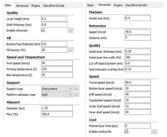

Cura settings:
Cura settings

  • Now you have your print settings added, I've updated the answer. Basically, you print too hot, too slow and have a far too high retraction length. This causes heat to affect the filament before it enters the nozzle, with high retractions (retracting hot/flexible of heat filament) you then quickly cause a blockage to develop. – 0scar Oct 12 '18 at 08:28

The article describes what steps you could do to alleviate the problem. Of all the suggestions, "Minimize retraction", seems a possible candidate for you to look into considering the posted print settings. As this is a heat related problem it is advised to also increase your printing speeds, these are pretty low (30 mm/s for slow and 60 mm/s for normal printing) and also check the cooling of the "cold end" (the fan that cools the radiator fins). Also reduce the printing temperature, 210 °C is pretty high for PLA filament, personally I don't go over 200 °C (note that this depends on your filament, but most PLA brands can be printed in the 185 - 195 °C range).
You have a pretty large retraction specified. The Ultimaker default is 6.5 mm is considered to be large, but works perfectly for Ultimaker machines (read Bowden tube setup). In my Ultimaker 3E which uses all metal hotends, or, in my custom HyperCube Evolution, also Bowden, but with a lined hotend, 6.5 mm retraction works perfectly.

  • @TomasBy You should increase the speeds, current values are way too low. Only for the first layer you could do a 20/30 mm/s (don't go under 20). If it was my problem I would revert to default Ultimaker Cura settings and start over by first reducing retraction. – 0scar Oct 12 '18 at 09:14
  • @Oscar: there are quite a few differences between the default settings in the sw and the suggested values in the manual. I have now tried several different combinations of speeds, with low retraction and 200 deg. print temp., and am getting the same results all the time, with some minor variations. Under-extrusion apparently in the form of some temporary clogging (the filament spool does not move) but no actual clogging of the nozzle. I can extrude fine using the control panel. – Tomas By Oct 20 '18 at 14:29
  • @TomasBy That is the pain with those all-metal hotends (please confirm in the question that it is an all-metal hotend, so no PTFE lining in the heat break). It could be that when you extrude from the panel, the extrusion rate is higher than when you actually print, too low print speed cause heat to creep up. – 0scar Oct 20 '18 at 16:39
  • Well, I have tried 30, 40, 50, 60 even 70 I believe. In the manual it says 70 mm/s is the max speed. It does not really seem to make any difference. – Tomas By Oct 20 '18 at 16:42
