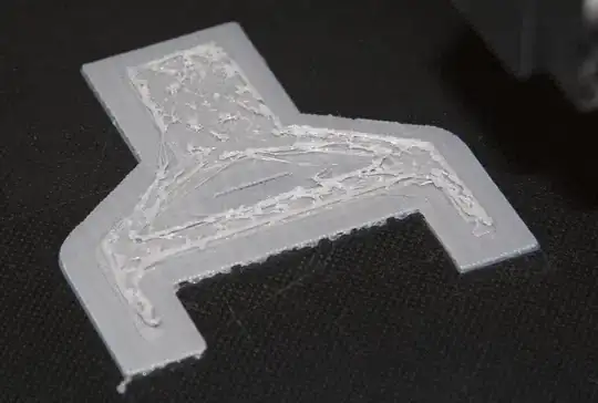

Trying to print a Pi camera mount, but am getting (I believe) under extrusion, as seen here.

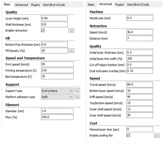

My Cura settings are these.
Does anybody see any obvious problems? What should I try to change?

Your filament is 1.75 mm, but you specified 1.6 mm in the Filament option Diameter (mm).
Furthermore, your layer thickness is very small (0.06 mm), why not try 0.20 mm first; a thicker layer will cause a higher extrusion flow. It could be that the print speed is too high for the low layer size.
Your initial layer 0.3 mm is also high, the maximum for a 0.4 mm nozzle.
Why did you change so many parameters? The standard values work pretty well.
  • It worked fine after I changed the diameter to 1.75 and the thickness to 0.2 (initial 0.25). – Tomas By Oct 10 '18 at 09:07
