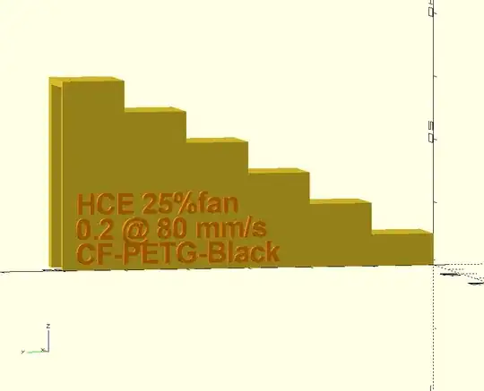

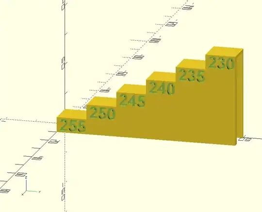

I use parametric stair case style calibration prints that include the slicer print settings that are to determine the best settings for temperature, print cooling, layer size and print speed.
Heat tower front viewHeat tower backside view
