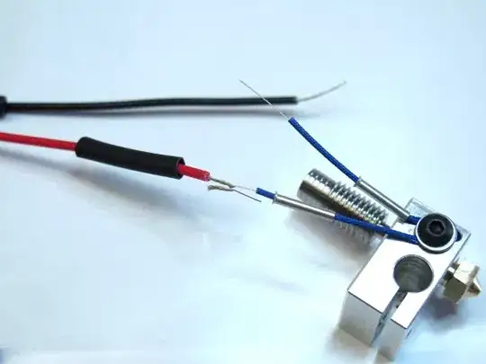

Additional info: Can't you clamp the thermistor the way it is done in the E3D V6 hotend, see this image?
Thermistor in E3D V6 hotend
Thermal contact should be quite good and you don't have any problems which could lead to damage of the thermistor.

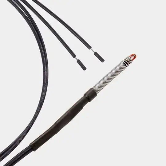

My thermistors came with a small spring surrounding them, which seems to work pretty well for this (see also E3D Thermistor Alternative). It's pretty close to the size of the spring in an ordinary pen, so you could just try one of those, or you could wind one from copper wire. I always use thermal grease as well, just like you'd use for heat sinks.
image from B3 Innovations - Thermistors (Gen1)
Thermistors (Gen1)

  • Can you take a picture please? I don't really understand how it can work :/ – Anton Osadchy Mar 07 '16 at 17:27
  • Here's a link to the picture from B3 Innovations, where I bought mine: https://www.b3innovations.com/wp-content/uploads/2013/12/Pico-Hot-end-e1417577727405.jpg This shows it installed on a hotend, but they sell the "thermistor assembly" by itself, or as mentioned you could do something similar. – TextGeek Mar 07 '16 at 17:33
  • Aha, looks really nice. It can prevent wire from banding, good idea. Thanks a lot man. – Anton Osadchy Mar 07 '16 at 17:45

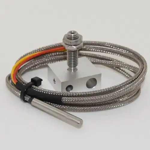

The main problem here is that the hot block has to match the temp sensor. There are a couple available commercial options for hotblocks with cartridge-and-setscrew temp sensors, but they're not thermistors:
Other popular options for thermocouples include a brass thermowell crimped onto the tip of the TC (Makerbot and FlashForge) or an eyelet lug crimped onto the tip of the TC (Wanhao).
The best off-the-shelf solution for most printers is probably to use an E3Dv6 hot block, which uses a screw and washer to clamp the thermistor leads so the glass bead tip can't pull free of its pocket.

  • Thanks man, "brass thermowell" is exactly what I was looking for. I just didn't know how to call it (maybe because I'm not native English speaker). Other things are really interesting too, thanks for your help. That is the link to thermowells I found: http://www.alibaba.com/product-detail/thermometer-with-brass-thermowell_1780646847.html?spm=a2700.7724838.0.0.vhGi41 – Anton Osadchy Mar 07 '16 at 17:43
  • Or this link: http://www.aliexpress.com/item/3-30mm-Stainless-Stell-one-End-Closed-thermocouple-Pt100-protection-Tube-thermowell/32307713415.html?spm=2114.01010208.3.119.bjO0ZF&ws_ab_test=searchweb201556_1,searchweb201644_2_505_506_503_504_10020_502_10001_10002_10017_10005_10006_10021_10003_10004_10022_10018_10019,searchweb201560_1,searchweb1451318400_-1,searchweb1451318411_-1&btsid=6d095233-1baf-4d07-95da-c21fd0d660a9 – Anton Osadchy Mar 07 '16 at 18:03
