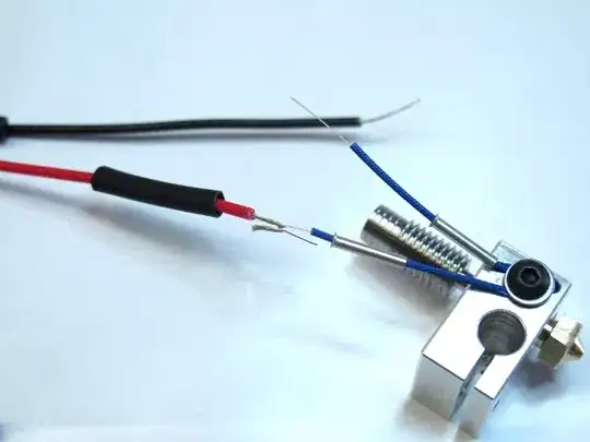

E3D hotends use a thermistor whose legs are insulated with glass fiber sleeving and clamped down with a screw and washer:
This solution enables the printing of high temperature materials, but it's a bit fragile and after reassembling the hotend a couple of times, the screw will have thoroughly mangled the thermistor's legs and sleeving.
Some knockoff E3D hotends use a (horrible) solution where the thermistor is just loose in its respective hole, and kapton taped to the heater cartridge wires which holds it in place:
This solution seems kind of ad-hoc, and I'm worried about the thermistor coming loose. One advantage is that it can be reassembled arbitrarily often, since just pulling out the heater cartridge also pulls out the thermistor without damaging it. Note that the picture shows PTFE sleeving which restricts the temperature, but you could easily use fibreglass in this situation as well.

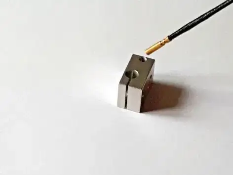

I have now purchased a hot-end block from here, that has a "cartridge style" cylindrical thermistor that fits into a drilled hole of the hot-end block, and is fixed by an additional screw. This system makes maintenance much easier, the thermistor slides in and out without force, and it has a connector to change only thermistor (or unscrew hot-end block without removing cables if your hot-end also has a connector).
cyclindrical cartridge thermistor
I highly recommend this upgrade, if you are using older-style hot-ends, because it makes maintenance much easier.
