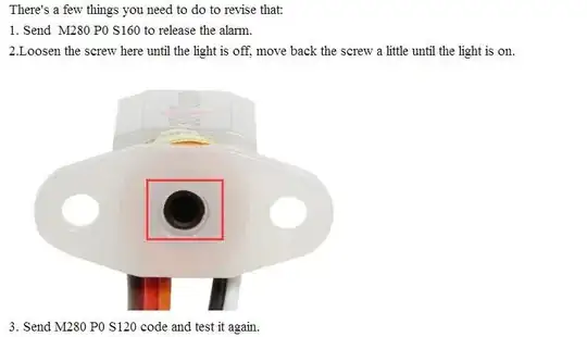

Digging into several posts I found this post that hints to a solution:
Instructions to adjust the 3DTouch sensor
After readjusting, the sensor worked and I was able to produce a print, but the next day it failed again... What I found is that the bed and extruder are NOT shut off while probing although that should have been enabled in Marlin 1.1.8. I assumed that this de-powering is only during the actual probe lowering, so very short. So I figured that this might be an EMI problem. In a last resort I updated to Marlin 1.1.9 which has the functionality to shut the power off for heater and bed and everything now seems to work perfectly. I now see that the de-powering is a bit longer and in fact the extruder temperature drops slightly, this has never been seen with the previous firmware version.
