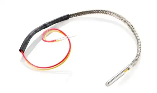

The thermocouple in question, on AliExpress was this, SWMAKER Thermoelement Typ K (TC) für Ultimaker Original 3D drucker 3mm K thermoelement typ für Ultimaker Original 3D drucker, ~$10
Or this, considerably more expensive at €33, Ultimaker Original - Thermocouple Sensor (out of stock):
