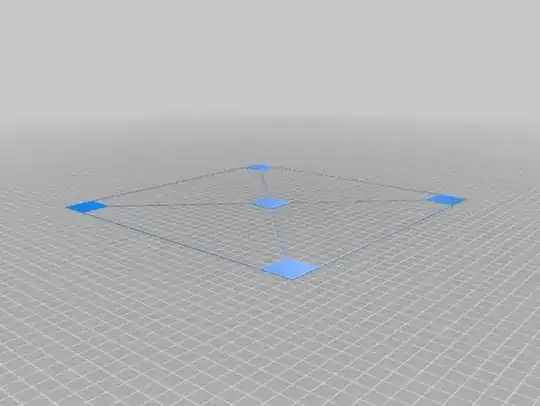

Another leveling and centering print that is created with OpenSCAD is this, and could be a start for you to create your own design:
leveling and centering print object
Note that the file with the design is located in the "files" section.

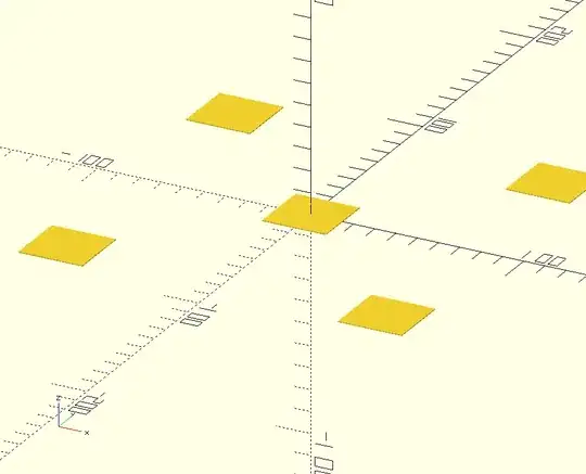

Edit: Some code for OpenSCAD made within 5 minutes (I don't type fast so it could have been faster if I did not use the constants, but if you go OpenSCAD, making parametric designs is almost a must ;) ):
// Set constants as you like
width = 30;
depth = 30;
layer_height = 0.2;
first_layer_height = 0.2;
nr_of_layers = 2;
box_size = 180;
// Calculated parameters
height = first_layer_height + (nr_of_layers - 1) * layer_height;
// Draw the test object
translate([-width/2, -depth/2,0]){
  // Draw the center square
  cube(size = [width, depth, height], center = false);
  // Draw the corner squares
  for (x=[-1:2:1]){
    for (y=[-1:2:1]){
      translate([x * (box_size-width)/2, y * (box_size-depth)/2, 0])
Rendered figure: rendered image of the 5 square level test print
