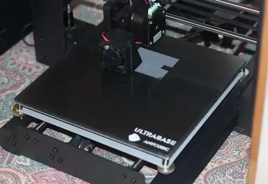

Have a Monoprice Maker Select v2 and have recently changed to an Anycubic Ultrabase glass plate. In Cura, the model I am printing is in the middle, as shown here:
but the printer puts it around 2/3 of the way up in the Y dimension:

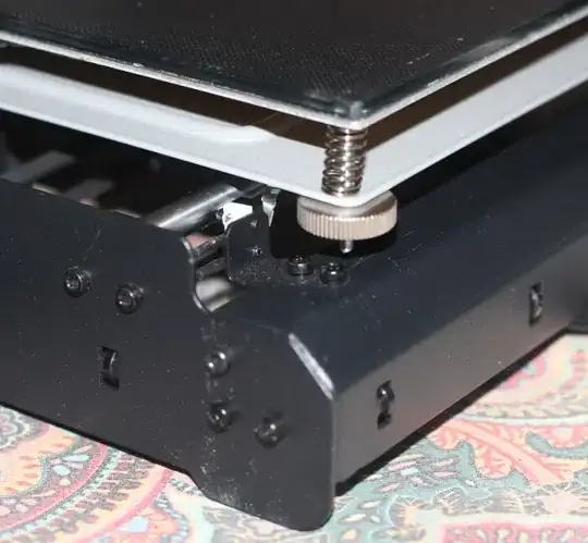

Even more further investigation: I have now dis-attached the Y-axis belt and moved it back and forth with no improvement. Also, the platform screws hit a couple of bolts at the back, which prevent it from moving all the way back (i.e. the extruder head forward), which seems to be the reason it is not getting to the front of the platform. I think I will have to increase the Z position first.
In the above picture, the platform is much higher than the origin position. This is the `back left' corner. If I lower the platform to the nozzle origin, it cannot move all the way back (i.e. nozzle cannot reach front). The screws came with the plate (and are different from the ones I had before). With the platform at the height shown in the picture, it moves freely all the way.
So the question now is: how do I change the Z-axis "origin" position? Have tried to manually adjust and then select "set origin" on the printer menu, but it did not have any noticeable effect. When selecting "home" it goes back to the old position.

I sawed off about 2 mm from the (bed) screw in the photo so it wouldn't catch on the screws of the Y endstop. It now works as before.
Detail photo of bed corner and Y endstop
If somebody has a more cerebral solution I will gladly `accept' it.
