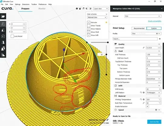

Why does this happen (circled in red), and how can I fix it? It is making my prints come out horrible.
Not shown in the picture, but the option "Coasting" was Enabled:
  • Coasting Volume 0.064 mm3
  • Minimum Volume Before Coasting: 0.8
  • Coasting Speed 90%
Rendered G-code view of a sliced model

  • Hi and welcome to 3D Printing.SE Could you look at the option "coasting" and report the value? – 0scar Jul 08 '18 at 16:48
  • Coasting was Enabled (Coasting Volume .064 mm^3, Minimum Volume Before Coasting: .8, Coasting Speed 90%). I've disabled it and it looks sane now. Feel Free to write an answer and I'll give you an upvote. – rjm27trekkie Jul 08 '18 at 17:34

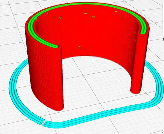

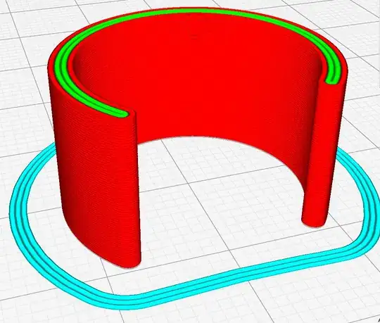

If you enable the option "Coasting", the extruder will follow the extrusion path at the end of switching to the next layer or the next section, but will not deposit any material as it uses the build up pressure in the nozzle to deposit the final bits. This shows up in your G-code representation by empty (non-depositing) gaps (in reality, when fine-tuned correctly, will be filled).
E.g. sliced without "Coasting" enabled: Print without enabling the coasting option
E.g. sliced with "Coasting" enabled: enter image description here
