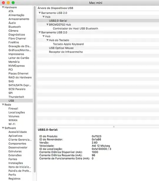

In OSX, I discover in System Information, an USB2.0-Serial, that I think can be the printer. Is it a printer driver problem? Is it the Cura setting? I'm completely lost...
OSX System Information - USB
There are a lot of problems with the CH340 chipset drivers to be found on 3D SE and various forums on the internet. To use this cheap CH340 chip that is used by a number of Arduino compatible (clone) boards to provide USB connectivity (a USB bus converter chip that converts USB bus signals to serial interface) you need to install a correct working driver.
For Mac OS X you can try to download a working version for the OS system you are using. You can try to use this driver installer or this driver installer. Both reported to work with Mac OS.
Edit: If you are using OSX El Capitan, please read this. To get the CH340 drivers to work you need to use the tool csrutil.
