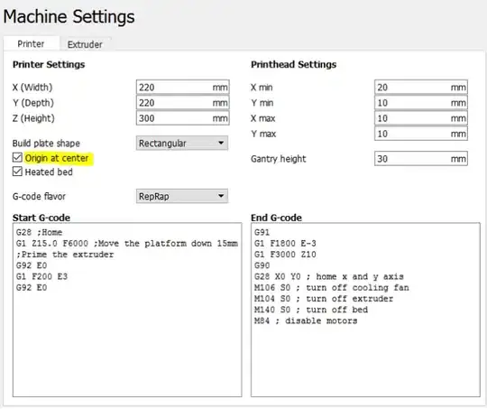

I tried printing a calibration cube. The first problem I noticed is that the printing is starting on one corner instead of the center as specified on the Printer Settings in CURA (check settings below).

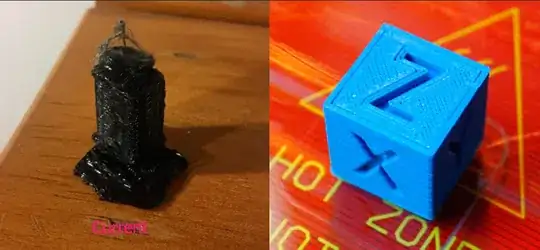

Second problem is that I'm getting significant distortion. The movement of the printer seems to be fine, no jerks of weird sounds. I tried all I know but I honestly don't know how to proceed with this. I have a couple of hours of experience in 3D Printing so I'm completely lost.
This is the result I got (Model printed with Raft for adhesion):
These are my CURA settings:
Printer
CURA settings - Printer

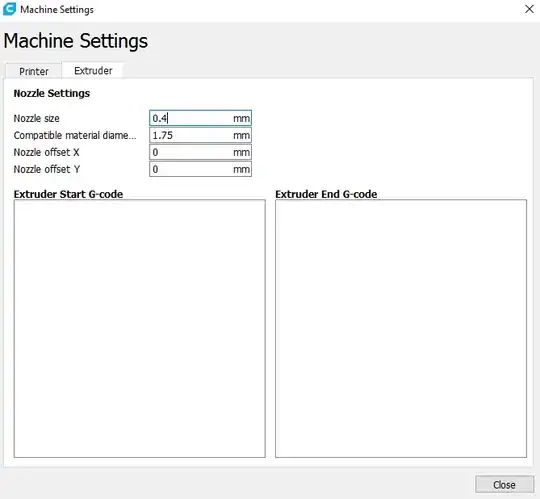

Extruder
CURA settings - Extruder

    Remove the tick mark of "Origin at center" your origin lies at front left. – 0scar Jun 20 '18 at 04:28
    The "Origin at center" does NOT say that your print will be start in the center, it says that the homing point is in center. Since this is very uncommon for 3 axis printers, you should try to remove this tick like @0scar said. Also other information like Material and settings would be interesting to help you. – Horitsu Jun 20 '18 at 05:19

The first problem is solved by removing the tick mark at Origin at center. Most printers have their origin at a corner (not Delta's, their origin is in the top center).
The second problem is a little more difficult to solve. Please note that a kit should be loaded with preset values that should be fair enough to print, your picture does not appear to print the calibration cube correctly, so you should try to eliminate each possibility one at a time. As said, your picture is not very clear, but it does not appear to be a cube, it looks more rectangular (also note that a raft is only interesting when printing difficult, read prone to warping, filaments like ABS).

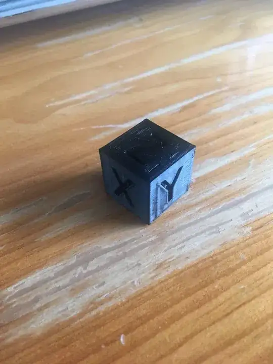

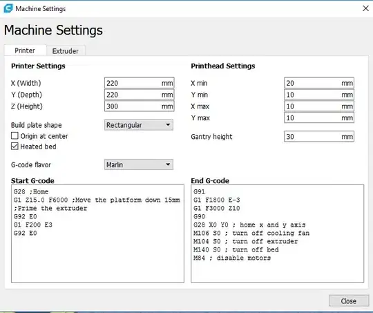

Fix was actually pretty simple.
I just removed the printer that I had setup on CURA following the manual provided by Creality (found on the provided SD Card) and started from scratch.
The one that worked was actually setting up the printer as a Creality CR-10 and then just changing the XYZ dimensions. This setup has the Origin at Center option unchecked as suggested in the comments. That's all it took...
New results: enter image description here

    You must have messed it up a little as what you describe what you did you normally would not get this much improvement! – 0scar Jun 25 '18 at 18:45
  • @Oscar : The provided SD card comes with a preset intended for the Ender4 the manual indicates to use that, however what worked for me was to start from a CR10 preset and change the dimensions afterwards. Not sure why the warping was happening but that fixed the issue. – Chepech Sep 24 '18 at 15:29
