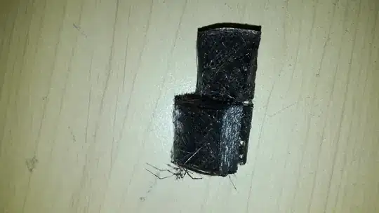

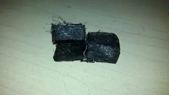

I am the owner of a pretty Anycubic Mega I3 and it was very cool to own it.
However, now I have several problems when printing with it. It clicks all along, at high or low temperature, at 5 mm above the plate, and the result is very disgusting. It is the same with the basic black PLA, or with other PLA from ICE-Filaments but I can't do anything.
I use Cura and I've reset it several times, using the defaults options or not.
Here are two examples of some prints (normal cube):
example 1
First example of poorly printed cube
and Example 2
Second example of poorly printed cube

I had a similar issue after installing an E3D V6 using a Bowden extruder.
PLA needs a heat break that has a PTFE liner, since with all metal heat breaks, it's probable that the filament will reach glass transition temperature in the heat break and stop flowing properly.
Also, I had filament that was 1.86 mm instead of 1.75 mm, which caused it to bind inside the PTFE tube.
Before correcting these issues, I was able to temporarily fix the issue by doing a cold pull to unclog the extruder, and was able to print around 10 cm in height of a 20x20x20 mm cube.
To do a cold pull, heat your extruder between 80-100°C, and then pull out the filament. If successful, the tip of the filament will be shaped as the inside of the nozzle. If needed, heat the extruder to 200°C and manually push the filament to fill up the nozzle and heat brake, then let it cool down to the above temps and do the pull.
avc
  • 89
The "click of death" is the feed bolt skipping as it chews a bite out of your filament. Your filament feed is encountering resistance and the feed bolt is slipping. I've seen that sad spaghetti so many times. After unclogging your head with a cold pull and cutting off the mangled filament, you'll have some things to try:
I had a Lulzbot with the older Bowden extruder and learned to prevent spaghetti air prints by: 1) replacing PTFE liners periodically, and 2) increasing temperature for certain colors. My black PLA required +5C over my natural PLA, which was a total surprise.
Now I have a new Lultzbot with the metal extruder and life is good. All metal hot-ends are so much nicer.
