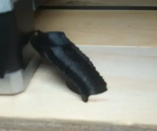

This piece is supposed to be straight up & down. Wild.

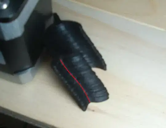

The moves that cause the shift are on this red line.

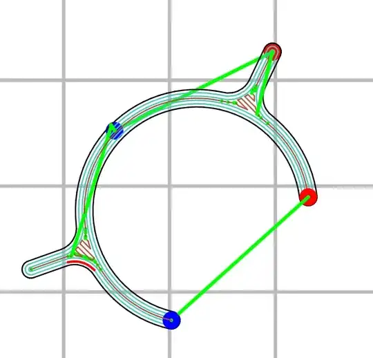

The issue seems to only occur on curved moves with a radius of approximately 2-3 mm that point their convex side towards the y-negative direction. Larger or smaller radius moves don't cause the problem. In fact sharp turns don't cause the problem either. Only 2-3 mm radius moves with their convex side towards y-negative produce the issue. No other kind of move causes the problem.
I think the offending move is highlighted here in red, but it might be one of the two moves either side of it. I haven't been able to narrow it down.

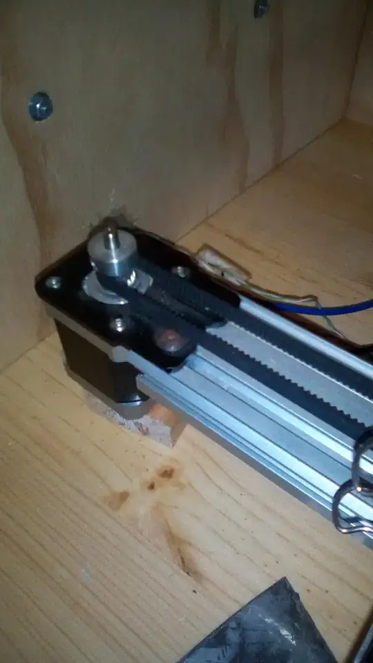

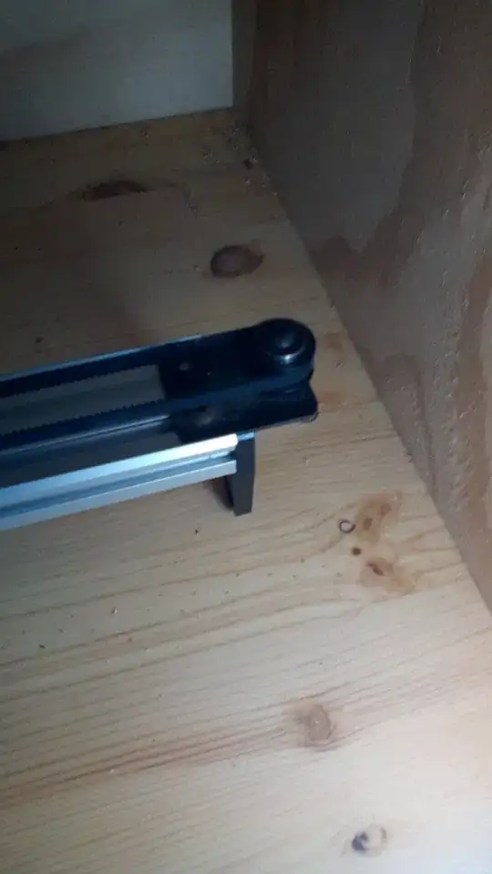

Here are some photos of the y-axis belt as requested:
Motor: Motor
Idler: Idler
