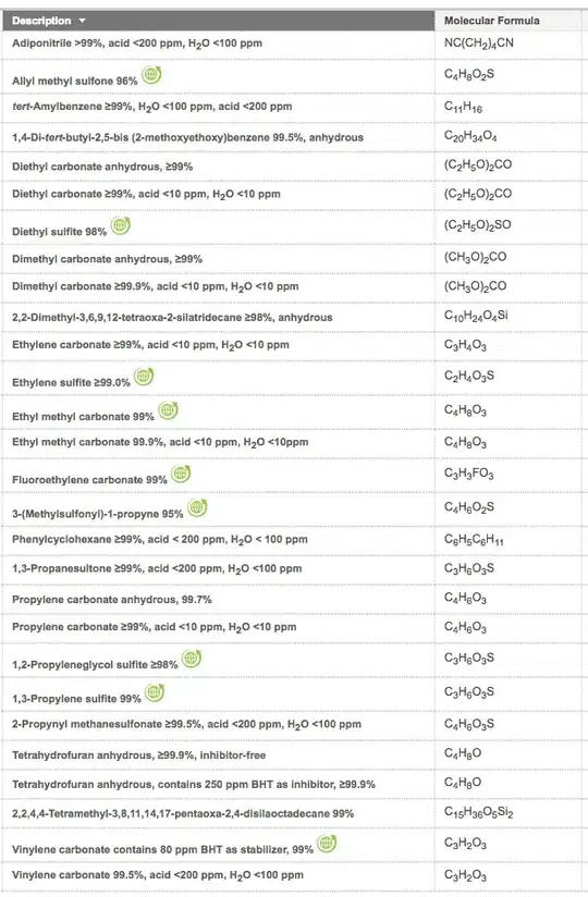

Discharge the battery entirely, then there is no danger of ignition if the membrane breaks. The battery cells are usually protected by Kapton tape (LiPo) or maybe even metal (LiIon). Both will withstand the temperature of 240°C. The downside is that the cells are damaged after a deep discharge. You should discard the battery afterwards.
What I would expect when you do that:
A deeply discharged battery will bloat up because the solvents will gas out. This will also happen if you heat up the battery enough (>>60 degree). The gases themselves can be ignited again but are captured in our air sealed Kapton envelope :) Igniting these gases will be comparable to a short flash with a spray can.
The temperature is not enough to damage the envelope. The solvents will be also not very dangerous in that temperature range. In case of mechanical breakdown of the membrane nothing will happen anymore.
From Solvents and Additives:
dgrat
