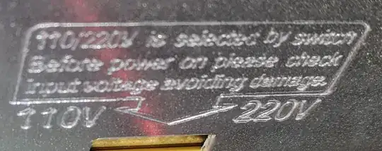

I don't know if this is the case with all FLSUN QQ printers, but mine was indeed set to 220v as the instructions/user manual indicated. First I needed to remove the bottom of the printer. Then there was a switch on the side of the power supply with the following label:
I know the picture is terrible, but the lighting inside the base of the printer was less than optimal. It should be pretty easy to find once you know what you're looking for.

1Thanks to @professor79 and Fernando Baltazar for their comments that got me looking in the right place. – linuxdan Apr 26 '18 at 06:39
Very nice to come back and answer your own question. Please accept your own answer after the waiting period. From Help Center: "You can also accept your own answer, but you must wait 48 hours to do so. After all, someone else may come along with an even better solution to your problem!" I doubt there will be a better answer as you investigated yourself. – 0scar Apr 26 '18 at 06:52
@linuxdan well done!, mostly power supply has this kind of switch. – Fernando Baltazar Apr 27 '18 at 21:31
My FLSUN QQ 2020 was exactly what linduxdan said, except it was 115v / 230v printed on the power supply. Thanks! – ZStoneDPM Jul 09 '20 at 22:23
