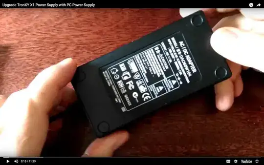

According to this video, Upgrade TronXY X1 Power Supply with PC Power Supply, which actually shows the power brick, the TronXY power brick is 12 V 5 A. The best screenshot of the brick is shown below:
TronXY power brick power rating
The narrator of the video (as do other sources) states that it runs extremely hot on long print cycles.
An example replacement power supply, on AliExpress, Tronxy 3D printer accessoires power supply 240W AC110/220V DC 12V 20A for 3D print DIY kit part, is rated at 20 A.
So, in theory any 12 V 10-15+ A rated laptop power brick should suffice.
However, that was not your question. As a standard RAMPS board also runs at 12 V, then yes, you can use the TronXY power brick with a standard RAMPS board.
