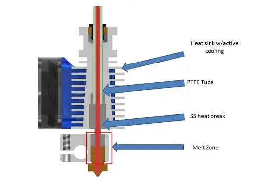

There are many hot end designs out thee and one difference is the length of the melting zone.
The melting zone is that part of the hotend where the pushed in filament is heated up and therefore starts to melt. Is it better to have a short melting zone, or a long melting zone? What are advantages of each solution. And are there materials that benefit from a short/long melting one more than others?

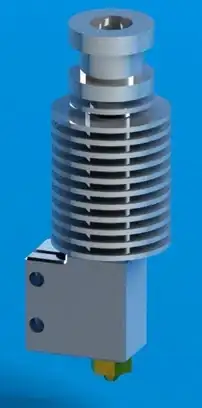

Example of those hotends are E3Dv6 and E3D Volcano
E3Dv6
E3D Volcano with a much longer melt zone than v6

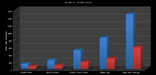

Speed comparison video:
Speed comparison graph: e3d speed comparison graph
