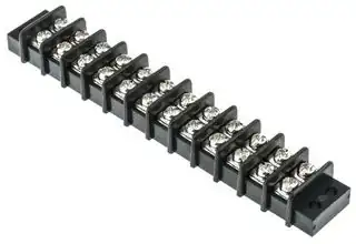

For these type of connectors:
screw connectorscrew connectors

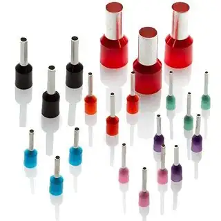

please use ferrules on the cable ends for wires that transport high loads/currents and use screw terminals:
collection of ferrulesferrules crimped on wires

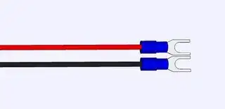

fork connectors
please use y-type or fork connectors:
fork connectorsfork connectors on cable
    ... and use a proper crimping tool. Crimping with a $20 tool versus some random pliers you picked up is not only much faster, but it makes a night and day difference in the quality of your crimps, and they will be MUCH less prone to failure. (so far, I've *never* had a properly crimped connector fail). – BrainSlugs83 Mar 08 '19 at 19:55
