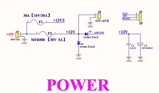

However, the PDF of the RAMPS 1.6 schematic shows the same rated fuses as the RAMPS 1.4
RAMPS 1.6 Power section
Nevertheless, that seems like a straight forward copy and paste from the RAMPS 1.4 schematic as it clearly references the MF-R500 PTC, and obviously SMD fuses have been used instead - or are the part numbers the same for the SMD fuses..? I had a google but couldn't see MF-R500 SMD fuses (maybe I didn't look hard enough?).
Footnote
1 This is because the 11 A fuse is only rated to 16 V. Note that F1 (MF-R500) is rated for 5 A at 30 V, and as such is sufficient for 24 V operation.
Without knowing the exact part numbers used for F1 and F2 it is impossible to say whether the fuses need to be replaced or not. However, based on the manufacturer provided schematic and BOM we can make a pretty good guess.
Looking at the PDF you linked, it states that F1 is rated for 16V. Looking at the BOM spreadsheet it also says F1 is 16V and 30A.
Based on the fact that the only two reference documents available say 16V, I would strongly recommend replacing this component for 24V operation.
