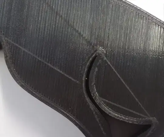

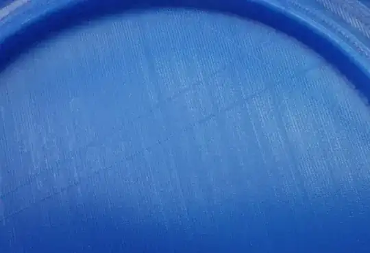

I'm getting seemingly random lines scattered across the top surface of my prints:
lines1 lines2
Printer: Anycubic i3 mega
Slicer: Cura 3.2.1
Printer chosen in Cura: Prusa i3, Gcode flavor changed to RepRap
Cura Profile: Fine, "Outer before inner walls" enabled
What might be the reason?

This is the result of travel moves passing through/over the top surface. The combing setting can prevent this type of move (for walls, infill or top), and z-hop can avoid making any mark during these travels.
Both settings will affect speed. Z-hop will be active on every layer, for example.

Our local library has a genuine Prusa i3 Mk2.5 that recently had this problem. Because of the number of fingers engaging such a system, it was not immediately discovered that a different profile had been selected in which the Z-hop was turned off.
Z-hop is a feature in which the nozzle lifts slightly (and is height-adjustable) as it moves from one portion of the print to another.
According to my brief research, Cura supports z-hop in the settings. Either it has to be activated or perhaps slightly increased. The aforementioned Prusa works great with 0.5 mm lift.
Thanks to the answers of fred_dot_u and Sean Houlihane, I did some more research.
There are three features involved here:
  • Combing (follow the already printed path when travelling)
  • Retraction (pull back the filament while travelling)
  • Z-hop (move the nozzle up while travelling)
The relationship between those settings is like this:
  • Retraction is only done when not combing*
  • Z-hop is only done when retracting
Therefore to lift the nozzle when travelling, one must disable combing and enable retraction and z-hop. This prevents the nozzle from scratching the surface.
* it was deemed unnecessary, but that might change in a future version; there is also a plugin that changes this
